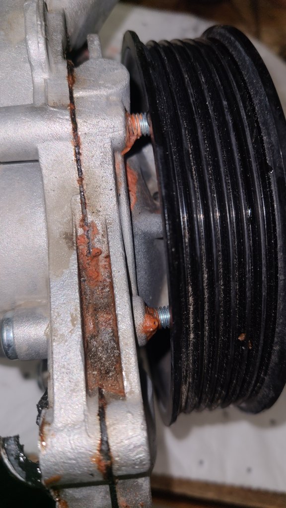

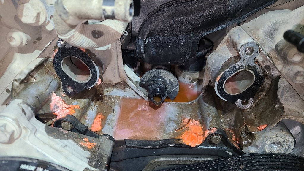

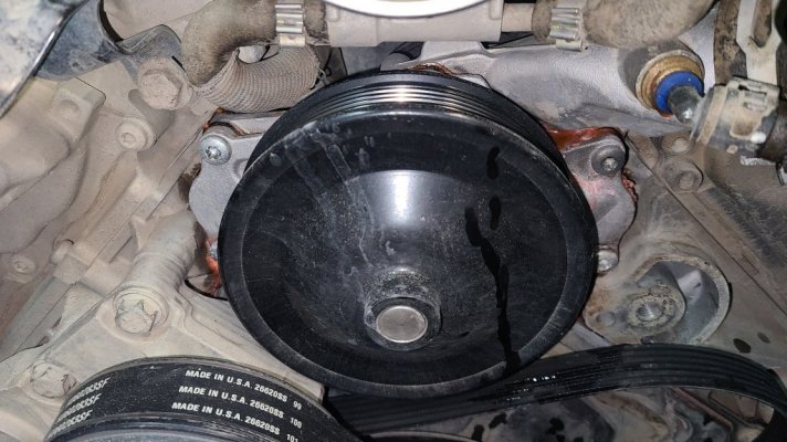

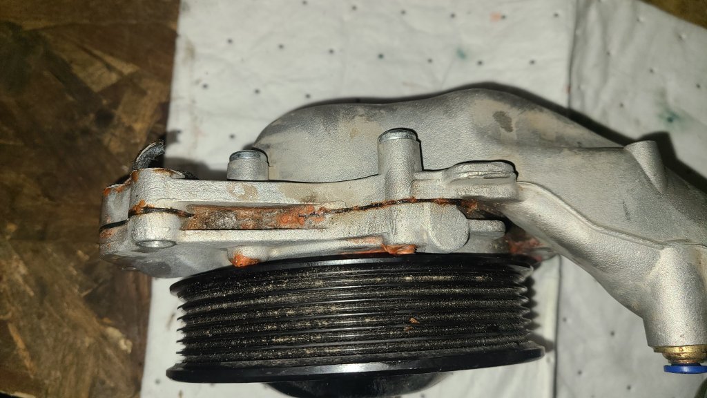

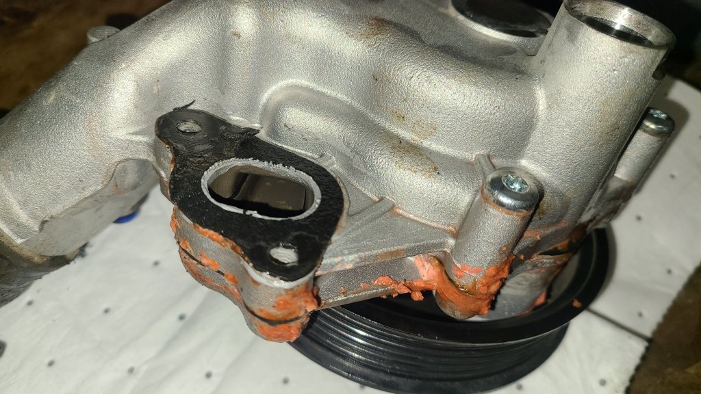

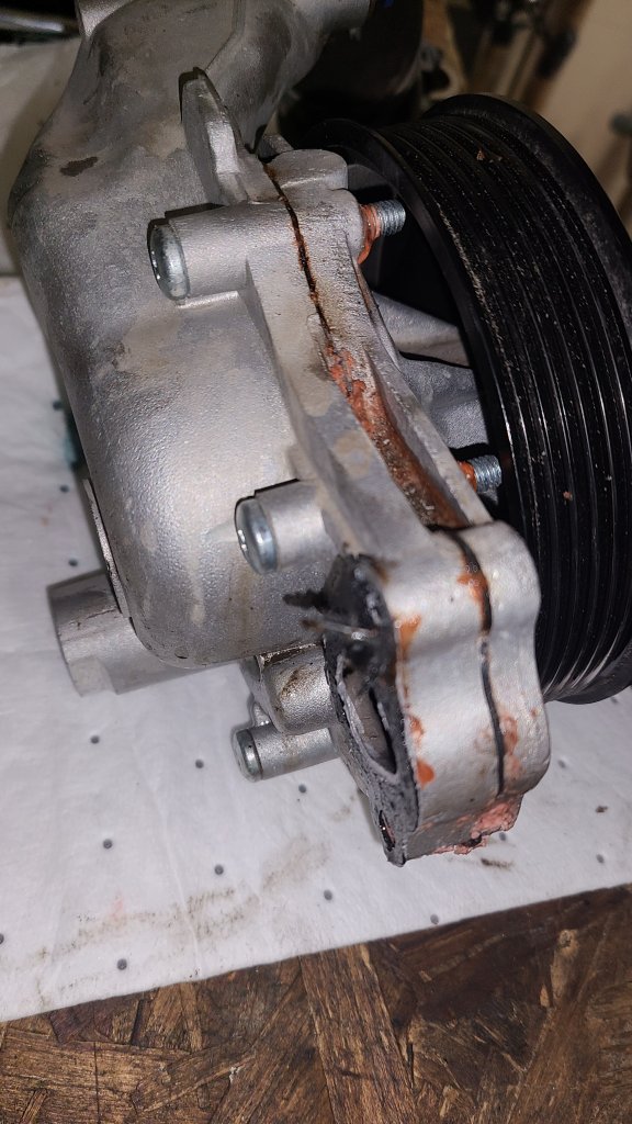

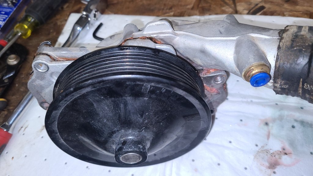

Pulled it apart today and expected to find the leakage coming from the left side of water pump (because of the top left bolt hole that I possibly stripped on install), but it appears to me that it's leaking from the seam of the water pump itself. I'm not positive though because I guess it's possible that the coolant could get distributed all over the pump due to wind and vibration? What do you guys think? Note on one of the pics looking behind the pulley you can see coolant on the bolt that goes through the water pump housing, but no trail to the bolt. I also should note, this water pump was purchased from Lucky8 and was installed 4-5 months ago and less than 4000 KM's ago (2500 miles)

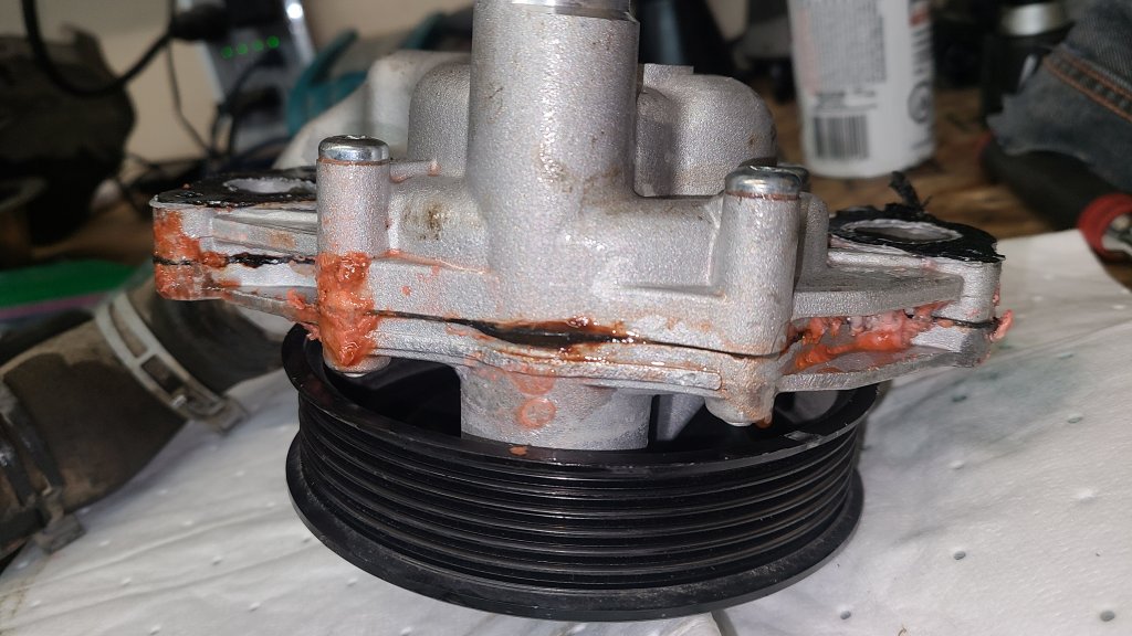

More pics

Certainly looks like a leak from the pump itself to me. The gaskets on the intake/outlet look like they’re degrading, at least from the pic. If so, I’ll bet the same thing is happening to the gasket between the two halves of the pump. I’d send those picks to Lucky8 and ask for your money back.

I had a cheap crappy pump last 5k kms before leaking like a sieve. Never again. OE pumps from here on in.
I agree, my mechanic says he will not install anything but OEM, if you bring your own parts you can also take them home.
