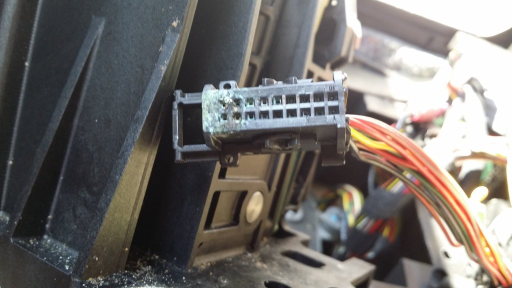

Did you check the connectors under the center console? If moisture got in there (small spill or sunroof leak/left open) some of the electrical pins can get corrosion on them and cause crazy errors.
