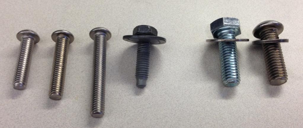

See attached. On left, the three lengths (25, 30 & 40) of M6 SS button-head screw I will try to replace the LR4 M6 screw (shown with its captive washer).
On right, the M8 zinc-plated Voyager screw and my replacement SS button head screw.

More info...
Turns out that you need at least a 30mm-long M6 to replace the M6 screw.
As for the M8's, the supplied M8 x 25mm-long screws are fine for the sides but do not provide sufficient thread engagement at the bottom. I will replace those with 30mm-long screws.
