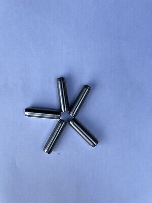

I know this is a bit on the old side, but I just found these:
Granted these are for the V6 supercharged engine, but I'm going out on a limb and assuming they'll fit the V8 5.0 engines. I'll let you know how it goes as I have my 5.0 engine at the machine shop right now. FYI, I purchased 32 of them for $380. (He had me order 5 sets of 5 and was going to ship 32) When they arrive in a few days I'll take them down and double check they fit my/our application and let you know.
Granted this is probably WAY too late for you, but maybe someone else will need the info? Or if you're anything like me, other projects have sidetracked you and the engine is still waiting for ya! LOL!
My local machine shop was able to identify valve guides with the same specs (inside/outside diameters and length) as found in some Subaru models that are readily available. I'll try to dig up the info for someone else's benefit.
Let us know how yours go!

Awesome! Thanks for the info! If the ones I bought don’t fit, I’ll order the ones you listed! I’m rebuilding the whole engine, and with everything apart, not doing the valve guides would almost be a crime!!!
Thanks!
Thanks!
Honestly, I wouldn't tear out the valve guides unless you really need to, well at least that's at the advice of my local machine shop. They only replaced 3 of them as the respective valves made contact with the cylinders bending the valves and loosening the guides a bit. They checked the rest of them as a precaution but there wasn't any excessive play anywhere else. Hope this helps!

Thanks for the advice! I’ve been talking with my machinist, and as soon as he gets the the heads, we’ll check the clearances per the manual. That said, I’m installing new valves all the way around…it’s a long story, but I bought a full set for a project I was thinking about, then went a different direction. With that said, I figure it’s better to have them and not need them, rather than get everything apart and then get stuck waiting for parts, shuffled back in line at the machine shop!
With a little luck the shop will get to it next week and I’ll let you know!
