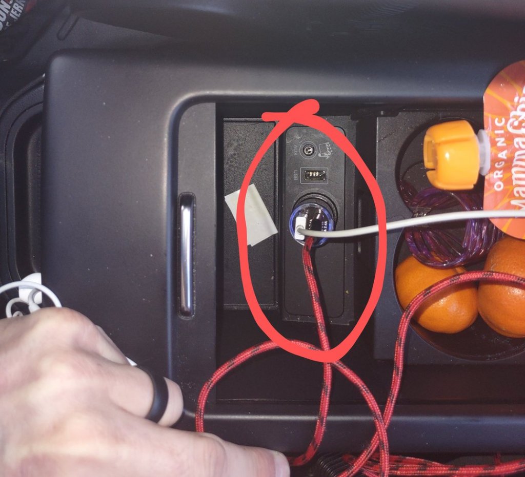

I have tried to find a writeup or video on doing this and it appears NOTHING exists. I found the rear and middle screws but the front ones appear to be underneath the center dash console, so I am thinking I may need to remove that whole thing as well (another thing I can't find any information on how to do). Does anyone have information on either of these?

I think if you remove the rear panel(where the audio jacks would be), you should be able to access the underside of your plug, but if not, powerfuluk made a video showing how to remove the whole thing.
