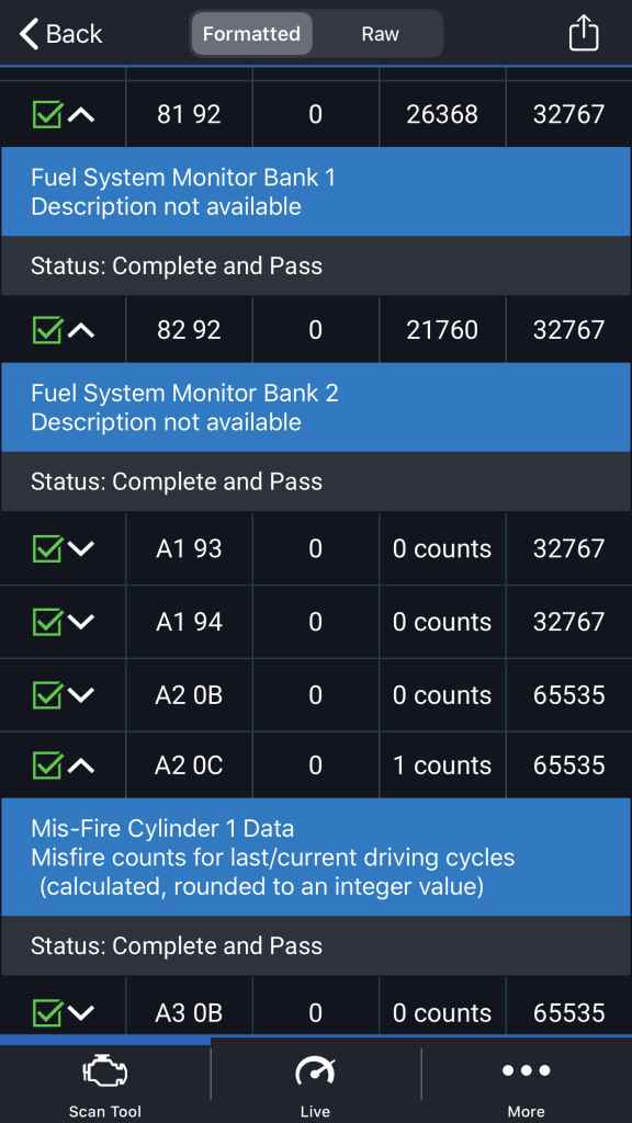

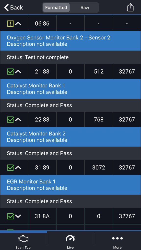

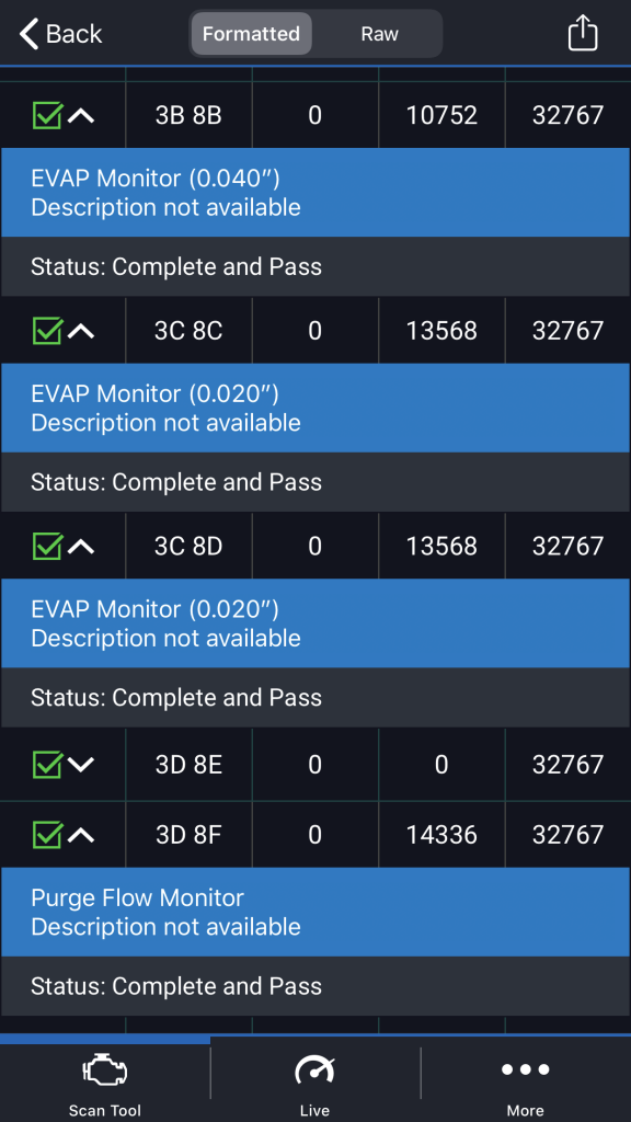

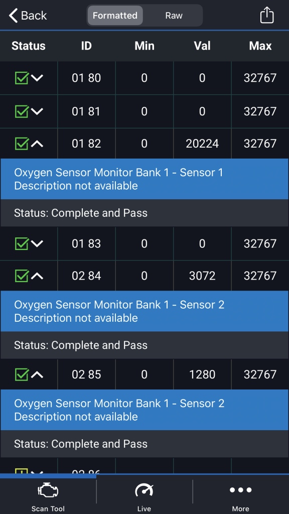

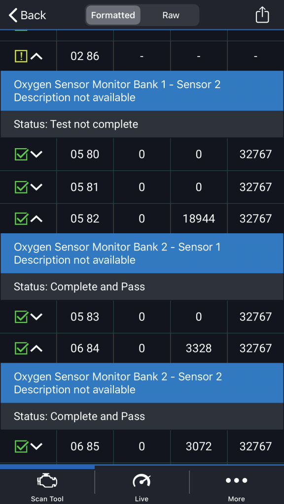

Recently I have had some nominal misfiring on a cold start, but have no error codes. Checking Mode 6 I noticed that the counters for some of the O2 sensors, which have a Min and Max of 0 and 32676 respectively are showing Values of in the 20k range. I 'think' the when the values exceed the max then the check engine light is triggered. Additionally over the last week some other sensors are also showing high counts that they were not previously showing.
I understand that some errors may be caused by other errors, and one should diagnose them in order.
Does anyone have experience interpreting this data? I have not found much about it, but it seems like it is rich information to keep the car running well. Do these values being high suggest that the sensors need replacing?
Some photos of the mode 6 display (It would not let me add them all).
