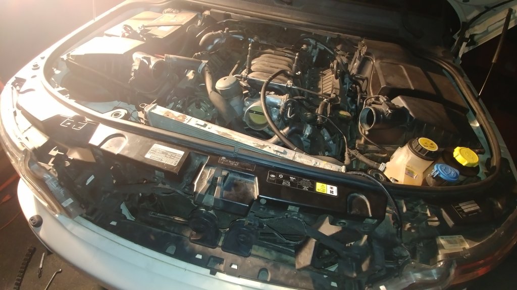

Any experience removing the radiator?
Mine developed a leak, detected with UV dye.
Have the radiator all disconnected but I can't seem to get it out of the engine bay. The flanges that mount to the frame stick out too far to lift straight out. I'm hoping I don't have to remove the entire front of the car.
Any suggestions would be appreciated.
This is where I'm at.
2011 lr4 86k, thought it was my water pump again but no

Probably not much help, but I seem to recall than on these cars, just about anything to do with the front of the car requires the front bumper to come off. I hope not, and judging by your photo you have it pretty loose there.
Good luck.

I was able to tease it out without taking off front end entirely. Moving expansion tank out of the way helped. My guess it was enginered for the right hand drive version, and they just made it work for ours.
Hopefully I can get it back together tonight.
