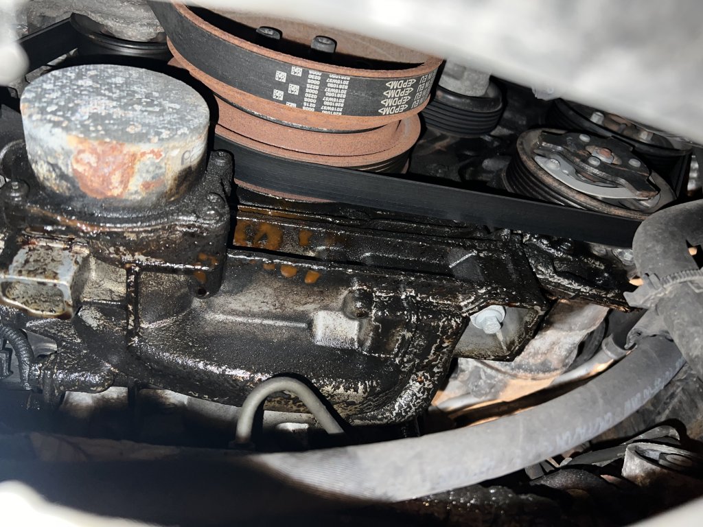

I have a 2012 with 89k. Don’t ignore coolant and or/ oil leaks from the front of the engine. Oil from the passenger valve cover can destroy the alternator.
I barley had any leak, until I removed the two front skid plates and saw this
It’s currently at the shop, having new guides and guide pins installed.
My leak oil was from the drivers side upper timing cover. Will be resealed during chain guide job.
My coolant leak was from a failing water pump and the front crossover. Doing a flush, rear crossover, and thermostat while it’s in. Also re-building the vacuum pump as it may have also been leaking.
