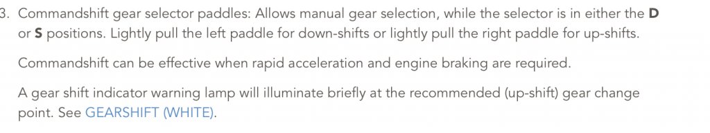

Yet another noob question: From what I can tell from the manual, the paddle shifters should be available to work even in Drive (D) mode. But they don't do anything on my LR4 unless I've moved the knob to the Standard (S) mode.
Is there a trick?

I stand corrected. I’ve never driven a vehicle that could be shifted while in drive mode, but just googling a bit, looks like many can be used that way with the paddles.
I just looked up the LR4 manual, and it suggests that this should be available in drive mode
I’ve not tried it (but I am always bumping the shifters, so thought I would have noticed this). In my google searching, it also looks like some land rovers had an option in the vehicle menu to allow this to be available only for sport mode, or for both sport/drive mode.

Yes, that's the part of the manual I'd read it in. And to me, it is expected behavior. Excuse me...behaviour. But it doesn't work.
