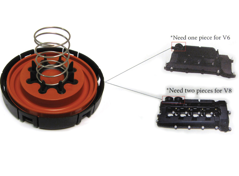

Yes you can buy a replacement pcv LR133579. Plastic cap must be removed by lifting six tabs and prying up on cap at the same time.
