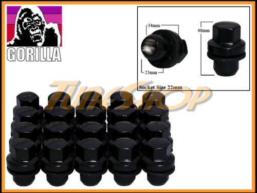

Make sure you are getting the correct style & seat if you need chrome. The Gorilla chromes on eBay for $40/set are NOT correct for the factory wheels, the cheap lugs are cone seat, not flat seat. Yes, I know the listing claims "fits LR4" but not with factory wheels:
https://www.ebay.com/itm/91743-Gori...one-Seat-Lug-Nut-and-Lock-System/231880004890
$40 sounds about right for one wheel, not a full set of 20.

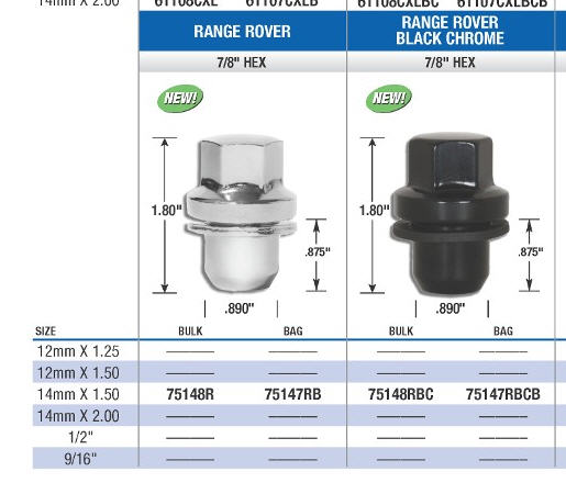

The Gorilla website is pretty bad... no search feature, no catalog that I could find, but anyway - see attached photo.
AFAICT the 75147RB at Summit is a bag of 4, so you may need 5 bags, plus an "additional shipping charge" which bumps the total to $155 for a set of 20. Unless I'm missing something? Oddly, it appears cheaper to buy 20 individual lugs from Summit, cart shows $140 total.
