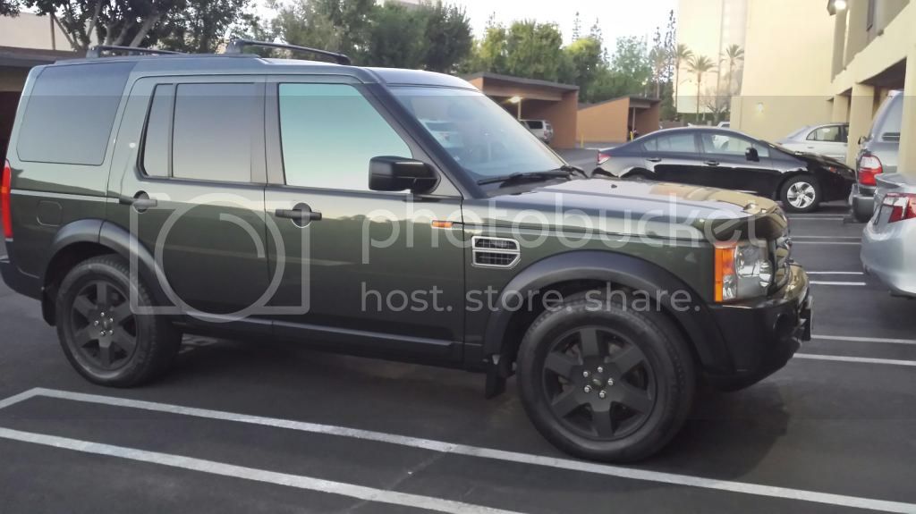

Purchased my 2005 Tonga Green LR3 SE7 used in Dec 2010 with 47k. Bought extended warranty for 3 years or 75k.
Overall functionally of the car was great. Great car for long trips. The extra 2 jump seats came in handy. Was told by passengers that the ride was smooth and comfy. Extra 2 jump seats were roomy. Great car for outdoor activities. I used my LR3 for camping, mountain biking and snowboarding, it satisfied all my needs. Only issue I had was with the Yakima Stickup tray style bike hitch which had issues folding up due to the location of the OEM tow hitch being further in then the rear bumper. Temp fix was to remove the tray closest to the rear bumper to be able to fold it up. The fix would be to purchase a hitch extender (2 extra inches of clearance should do it).

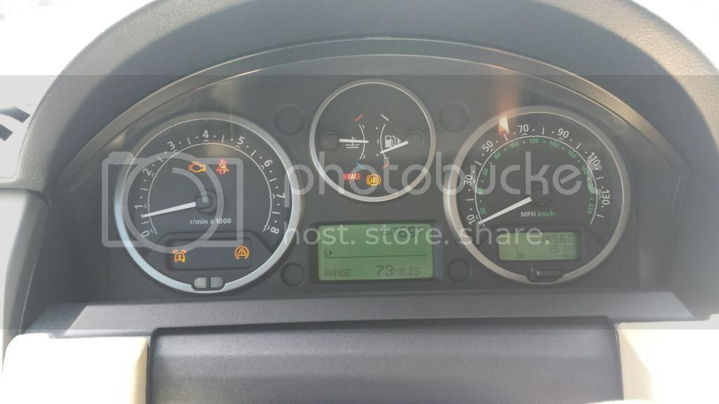

ABS module Failure - Loud hissing noise coming from the drivers side of the engine bay. At first I though it was the air suspension. No HDC fault codes message or lowering of suspension thankfully (See picture). Not covered under extended warranty. Cost was about 400 dollars to rebuilt the ABS module plus labor which wasn't to bad.
