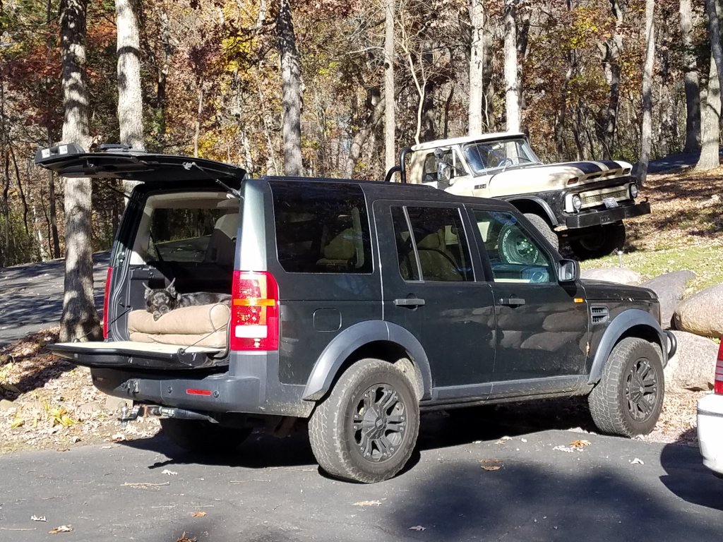

Anyway, tires continued to wear. Rear tires especially. Uploaded a picture that shows the rear tire wear, and my dog Jack, who has claimed the back of the rover as his.

FYI-tires wear more on the rear inside edge on independent suspension vehicles, Lr, bmw, audi, etc. even though front gets the turning, they wear more evenly across the tread.

Thanks for replies. I'll call the place I bought it and ask the questions. It was shop owner's vehicle, he used it to drive to work (3 miles) and shop used it to trailer tow in cars needing repairs. Didn't know enough to recognize or ask question about original wheels. I notice the rear tire wear, but it wasn't as worn then. Another 10k miles and it showed worse.
I did a few searches on tire wear, and wear on old tires matches pattern of under inflated example. Maybe somebody let some air out off-road and ran them home that way..

I don't think running with low tire pressure back from a trail one afternoon would cause uneven wear like that...of course, depending on the distance between home and the trail head.
