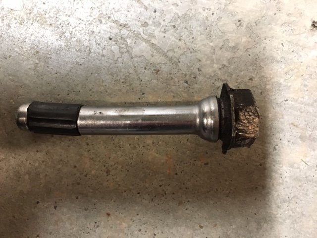

Are they stuck on the caliper pins or are the pistons sticking? I am betting the caliper pins are sticking and they can't remove them from the caliper. These pins need at least once a year and better twice a year cleaning of the pins and a regrease with a silicone based lubricant which won't screw up the rubber bushing on the lower pins.
This is the result of a swelled caliper pin bushing. It was close but I had to remove each caliper to my bench vice and work it with a BFH and chisel to get them free. This LR bushed caliper pin is the nastiest caliper pin in the universe.

Bushed caliper pins only go in the bottom position as per the service manual. The top pins have no bushings. Shops constantly get this wrong although I honestly don't know if it makes a difference. The frequent use of a silicone based lube is very important.
