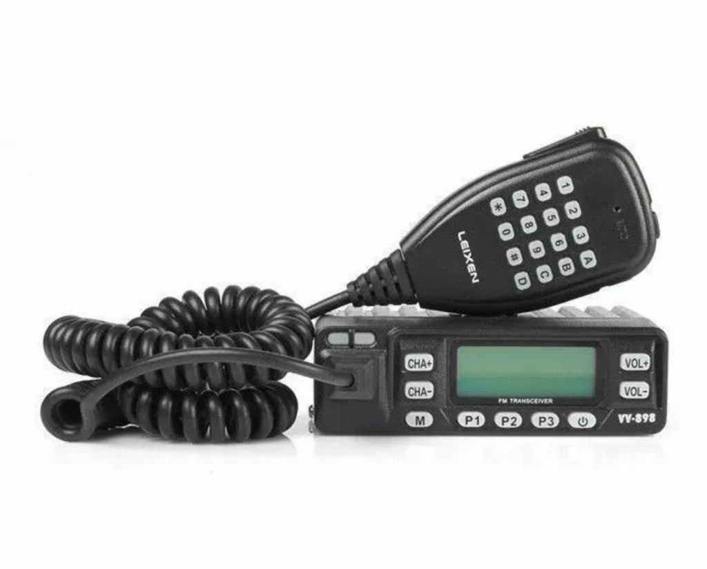

Got the ham radio coming.
shallow mounting depth should allow for it to be mounted under the factory location for the ash tray. It also covers the grms frequency's as well so I can use it either way on the trail

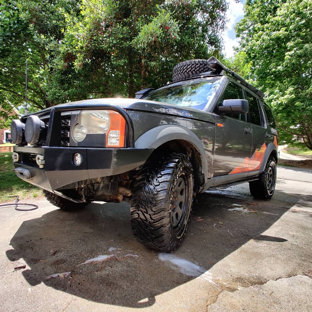

Today we pulled the CB, antenna and antenna cable from my Original LR3, along with the wiring relays etc for the front lights so we can start laying out the electrical. My Dad is back in town and we are isolating of course to be on the safe side. So he will start running wiring etc like this in his free time when my daughter and I aren't there working. So now we have shifts going on this thing lol.
He and I discussed adding a dual battery system so I am going to do a bit of research on that.
Picture of my current LR3 just because it looks so good when it's washed up
body damage and all.
