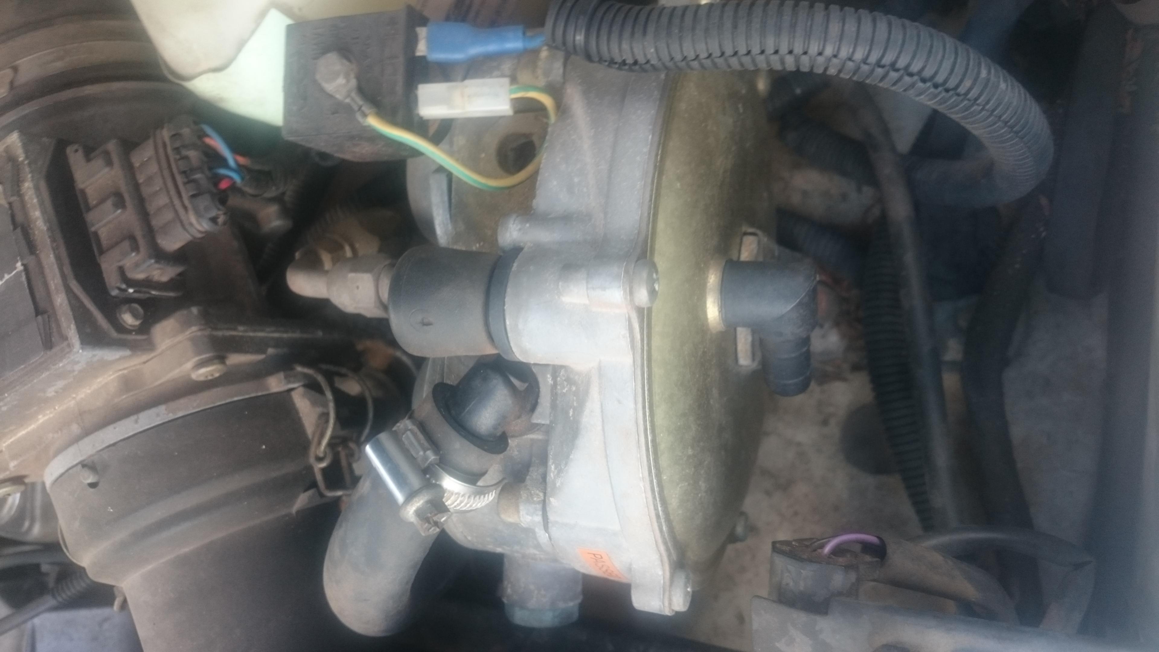

Hi all,
I have Discovery 1 1997 SE which runs on petrol and LPG.
I have a gas leak from the black elbow shaped connector in the picture.
It was never connected to a hose, but recently there is a strong smell of LPG from it.
If anyone has any explanation and maybe how to fix it, please share it.
Thanks in advance.
Ivan
Either the regulator is going bad or something should be connected to it. If nothing has been, cap it.
witv1
Feb 18, 2011
Thanks a lot.
I turned out there was quite a bit of corrosion and the diaphragm was busted too, so I am in for a new regulator.
It did end up costing $840, half of that for the new regulator.
