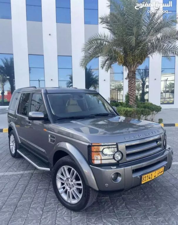

Hi, by the grace of god I bought a lr3 ,2007, clean with complete service and mechanical history, only driven 194000 km and the suspension and compressor was just replaced by a new one and had 2 complaints while I was buying but I was aware and the x-owner itself told me . ( I was aware coz it was there when I bought it )
1) parking brake ..
a) C1A43-00 (A8) Motor failure/electrical error H-bridge
b) C1A00-4B (A8) Control module System internal failure - over temperature
2) fuel gauge
a) B1A76-92 (AE) Fuel sender 2 circuit Component failure - performance or incorrect operation
but there are new codes showing up and i am not sure where to look into first please help me understand this and how to resolve this because I am looking forward to keep this truck always with me coz I loved LR3 and bought one … ( these are new and I am not understanding why these came up please help me with these )
1) instrument pack - U0132-87 (2E) Lost communication with ride level control module - Bus signal/message failure - missing a message
2) suspension - C1131-92 (28) Air supply - Component failure - performance or incorrect operation ((((the compressor and the suspension is brand new just installed this month only))))
3) body control - Key transponder - Bus signal/message failure - missing a message
guys please help me out..
