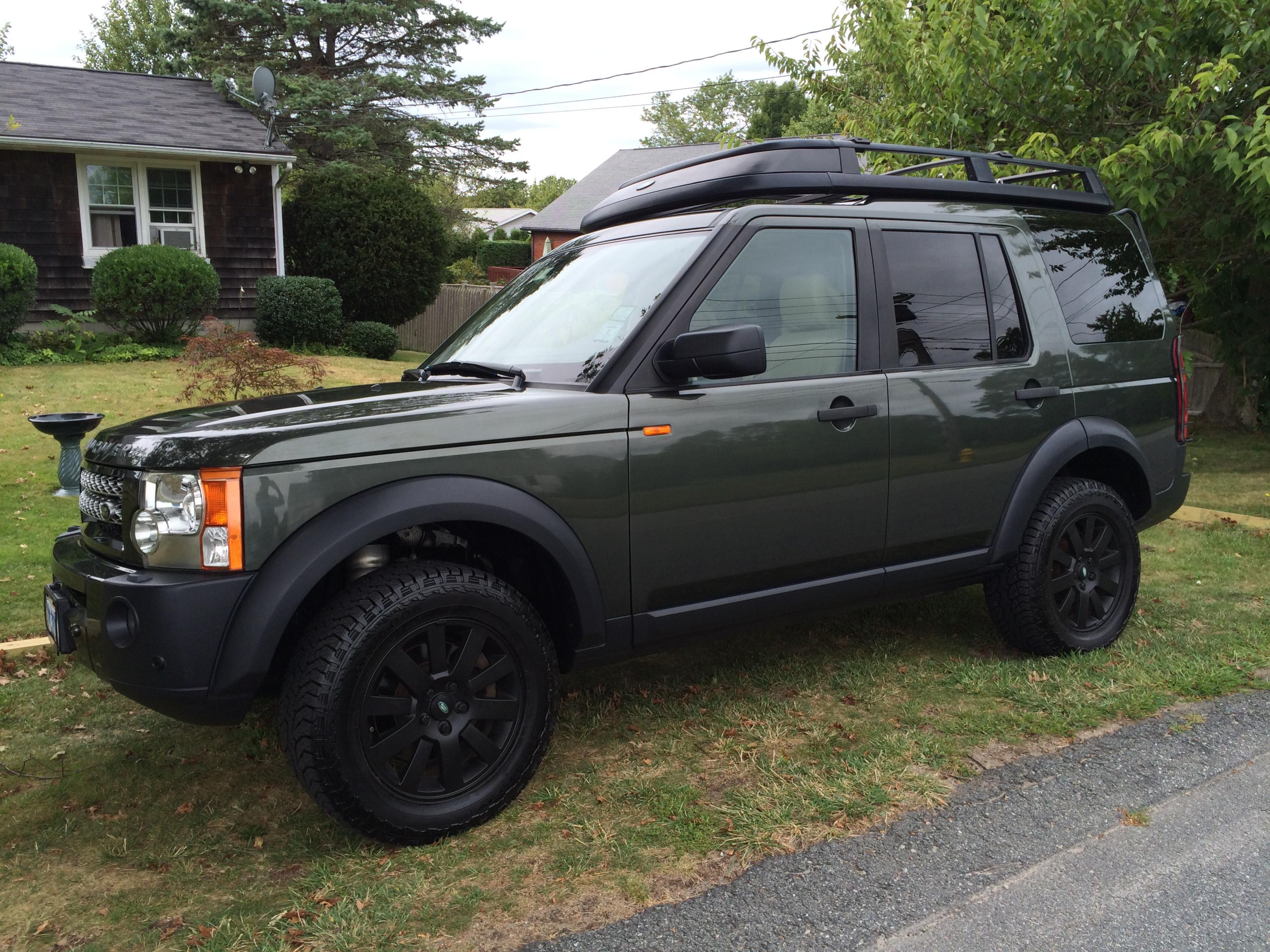

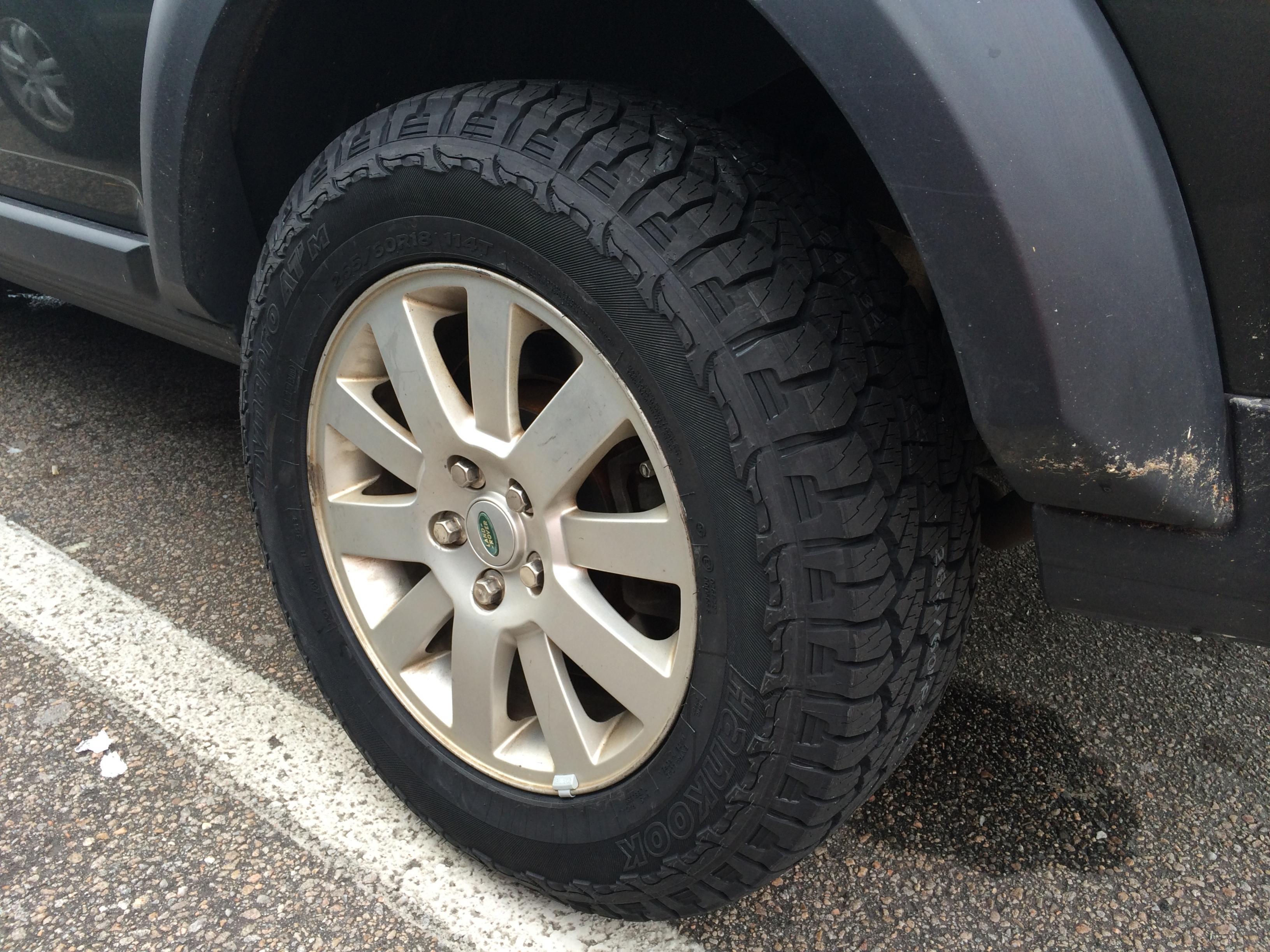

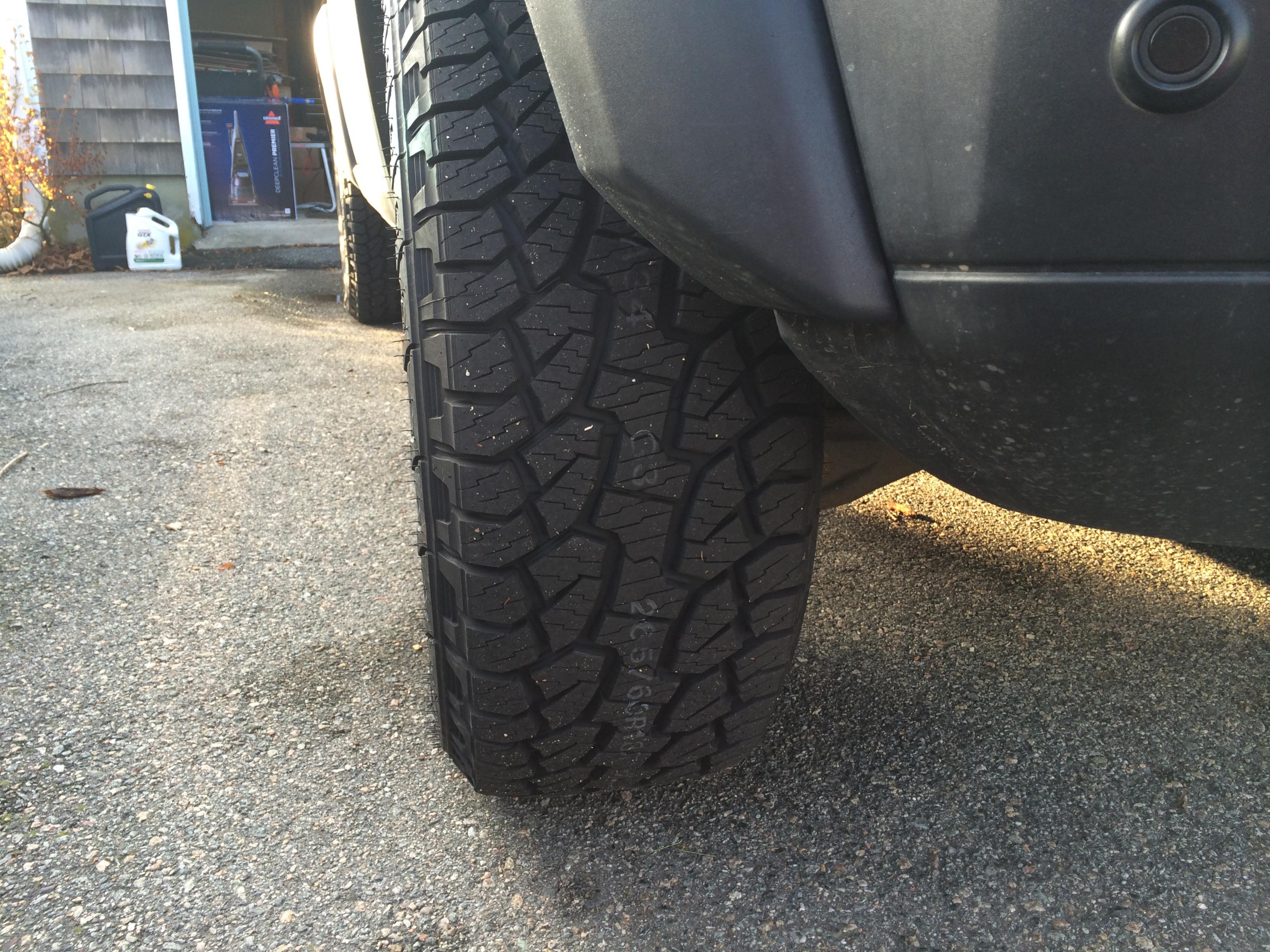

I got mine through Town Fair Tire, if they don't have the tire in stock they can order them for you. Or you could order them through amazon, discount tire, etc... if you go to amazon you can read the great reviews these tires have in cold, icy snow condition.
http://www.amazon.com/Hankook-DynaPro-RF10-Off-Road-Tire/product-reviews/B004QL68RI
I love these tires because they are not too wide and track better in the snow. I use to have the 285 wide nitto and they were a bear, heavy and wide. These tires are aggressive and work great! At least for me.
