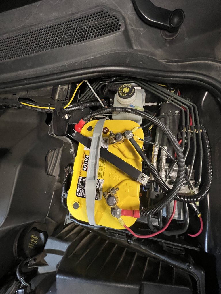

My question: on a 5.0 powered LR4 where do you put the aux battery? It’s tight in there!

I installed the Traxide D3-BU kit. The main thing is clearing out space in the second battery tray - driver's side; to do this you need to move the ECU. The dust cover can be modified so you can keep the ECU covered - I don't think the instructions for that is in one of the websites below, but I'll keep looking.
Here's a photo of my second battery.
