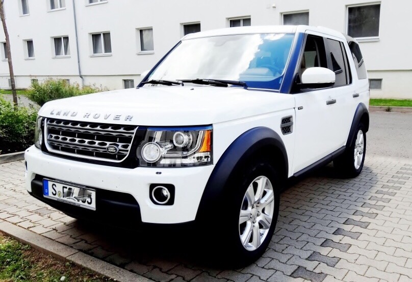

I had my wheel arches swapped when I purchased my 2014 HSE. Here are the part numbers.
DFJ000022PCL
DFJ000032PCL
DFK000045PCL
DFK000055PCL
DGP000145PCL
DGP000155PCL
DGP000124PCL
DGP000134PCL

Ah, excellent. That's your truck? Looks great. That's one of the photos I saw online that made me fairly sure this was possible -- plus seeing a 2013 disco 4 in Iceland with the swapped arches, too. Thanks for the part numbers. This definitely will not have the same visual impact on my black truck, but at least the arches will serve a purpose now.

Yes, that’s my truck. I ordered a US spec 2014 through LR Military Sales while stationed in Germany. I had the delivering dealer swap out the body colored wheel arches for the black ones. I never liked the look of the body color arches.
When doing research on whether or not the black wheel arches could be added to the LR4, I used the 1,000,000th Discovery / Journey of Discovery as proof that it was possible.
And ryanjl is correct about the non-US variant Discovery 4s having the black wheel arches available on the commercial and S models.
