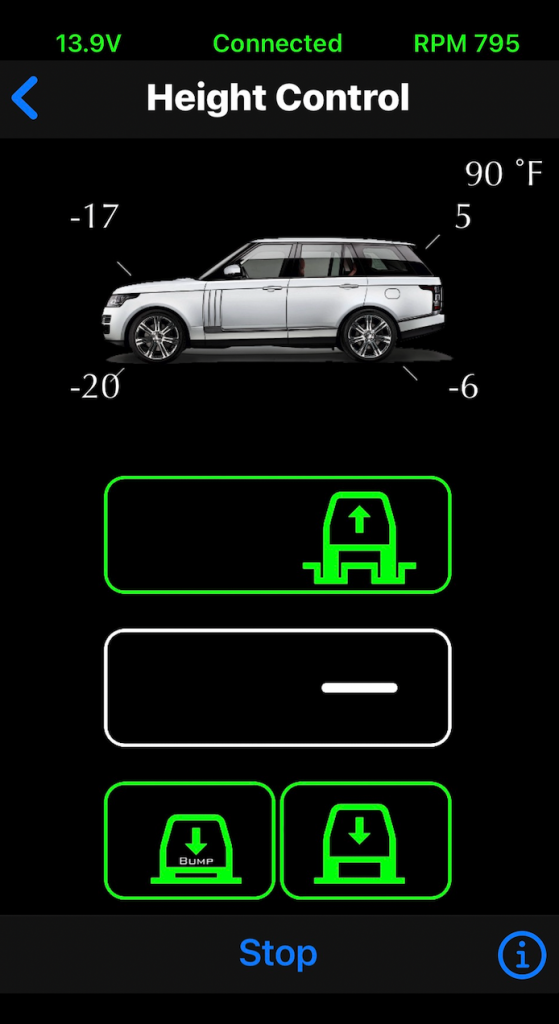

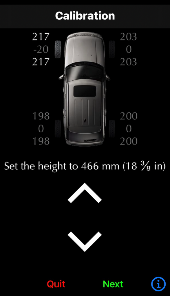

Literally the only things that seems to actually adjust height on my 2016 LR4 are these:
- the "height control" screen, which just duplicates the panel control, and
- the step-by-step "calibration" screen, which walks you through all four corners, where those main up/down arrows interact with the selected corner

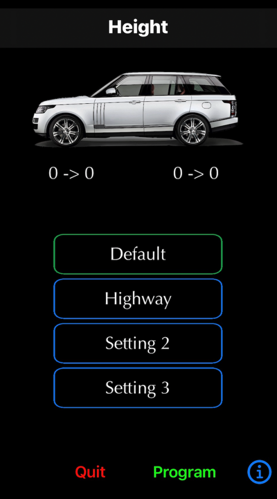

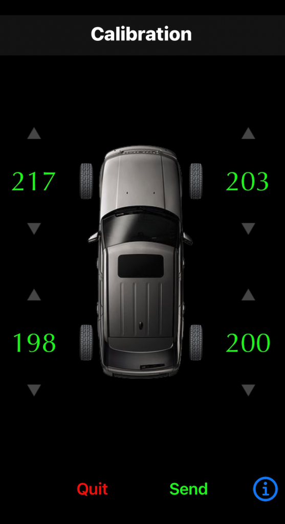

But there are at least two other screens that seem like they ought to do something, but don't. See attached.
The "default/highway/setting2/setting3" screen seems to do nothing. I can't interact with any of the UI elements, so I have no idea how I would set up any of those settings.
The other calibration screen would be really handy...if it did something. But only the wizard-style calibration works for me.

I may not be using the tool right, or not understand the limitations, or something. But...
The "height control" is similar to the actual button to lift/lower the vehicle and the oem restrictions apply.
Calibration is to calibrate the height sensors according to factory specs. I recommend staying within a 15mm or 1/2" from factory specs posted on the guided version. Anything more or less will eventually result in suspension fault issues. I have first hand experiences, trial by error.
The "default highway/setting2/setting3" is the screen you want to make custom adjustments. Just long-press each one of them to customize it, name change and 5mm increments. For example, you can name it "Levelled" with a +15mm only in the front by unlocking the front and rear link. Other example, "+30mm" for a 1.25" lift, "+55mm" for a 2.125" lift, or "-15mm" for -0.5" drop.
