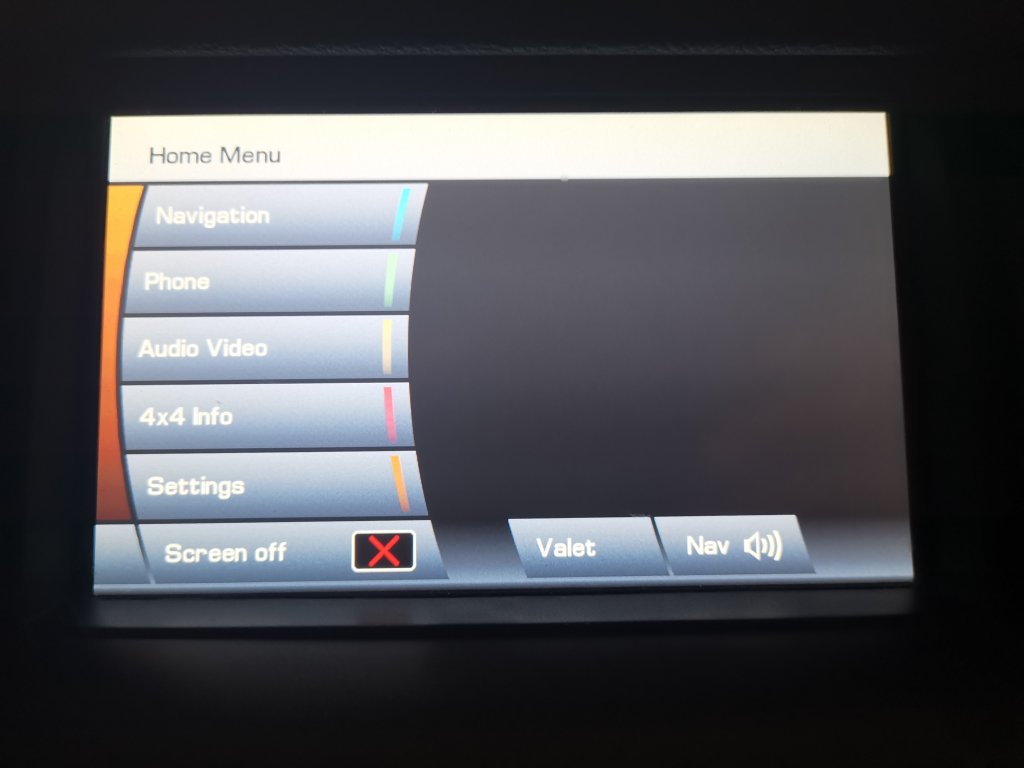

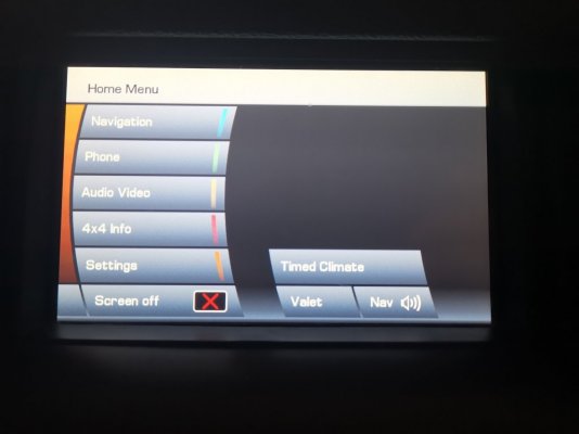

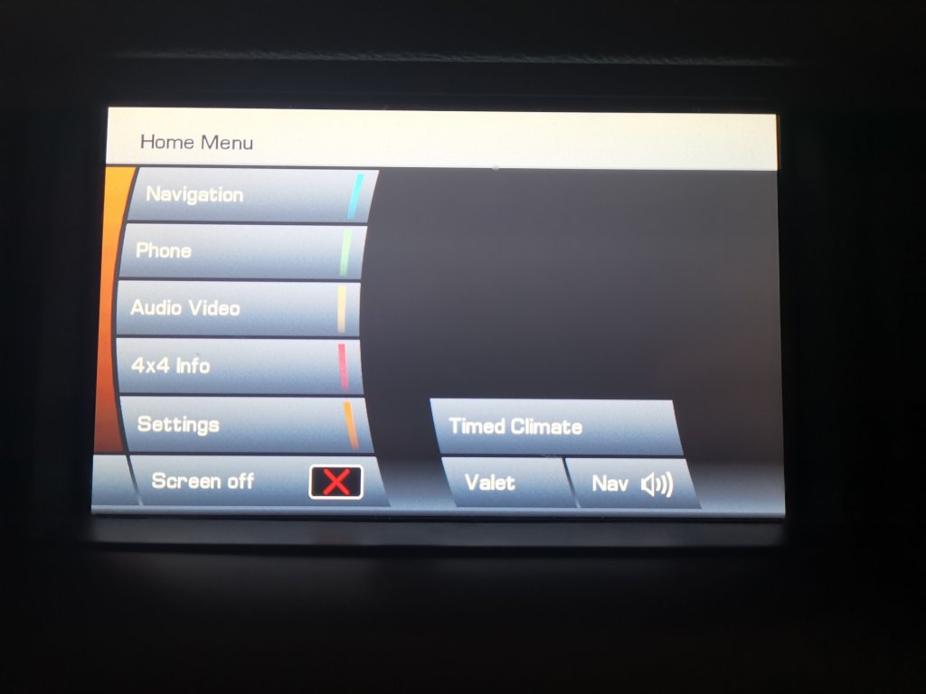

I enabled the HVAC in readiness for winter (I have the fuel burning heater installed), looking forward to testing it:
From main menu: Car Config > Confirmed List... >HVAC Ventilation
- "Timed Climate" set to "Enabled"
- "Fuel Burning Heater" set to "Fitted Parking Heat"
- "FBH Call Start" set to "Fitted Radio" (Activates the setting on the main menu of the Touchscreen)
