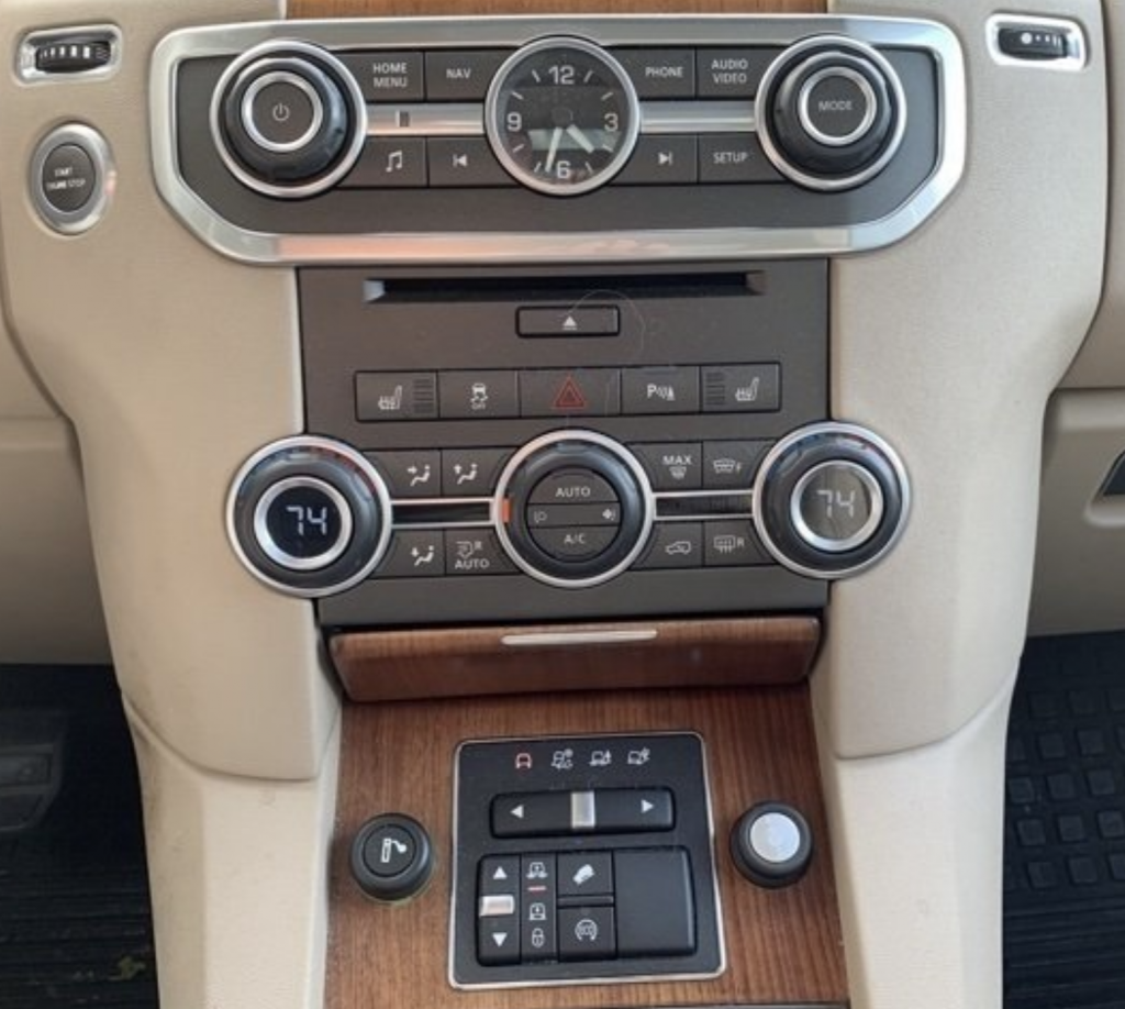

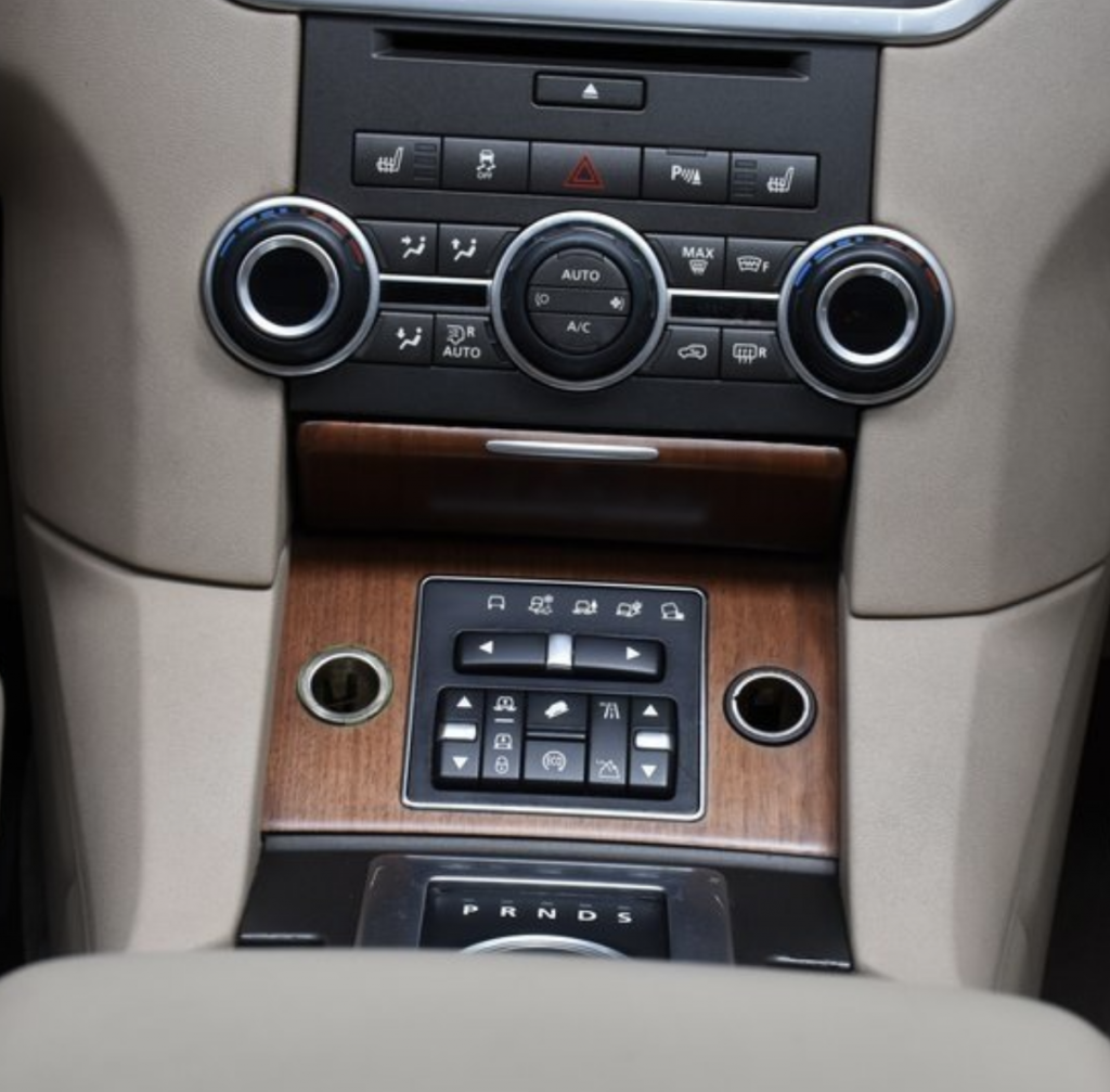

I have a recently purchased '15 LR4 that I won't do any heavy duty off-roading with but someday I might want to get a second vehicle for exactly that purpose. To that end, I am combing through the forums on how one could spot an HD package on the earlier V8 LR4's but have yet to find a method as easy as figuring out a later model SCV6 14' - 16'. On the terrain selection buttons for the SCV6 HD Packaged LR4's your standard non-HD truck has only 4 modes: Normal, Snow, Fire Road/Trail, Sand. The HD models will have a fifth mode to include Rock Crawl. These two photos show the difference and on most ads on Autotrader, it's easy to spot. The question I have for you all is whether there is a likewise easy sway to spot the HD Package on the V8 earlier models of the LR4.

Thanks for your reply. As you can see from the photos above, figuring out whether an LR4 has the HD package in the years '14 - '16 is as easy as looking at photos in an online ad. With so few of these cars spec'd HD, one's search would probably have to be Nationwide or at a minimum many miles from their location. Traveling to inspect a car's underside may not always be practical. Arranging to ask a salesperson to do it while reasonable, can get intractable when you are searching through literally hundreds of cars. What I wanted to know was whether there was a tell tall button or switch like above that gives away the HD package simply by clicking through photos.
No. Prior to '13, the HD package only meant it had a locker in the rear axle. Everything else was the same, including all the traction modes.
In '14 and after, the low range transfer case became part of the HD package. That's the switch in the right side of that switch cluster in the photos you posted, where there is a switch on one and a blank on the other.
Other than looking for a full-size spare (which can be added to a non-HD model) or wires leading to the rear axle, the only other way to tell is to pull up the 4x4 screen on the dash while the vehicle is running and look for the lock icon in the rear axle.
You could also, presumably, figure out a way to tell by VIN. That may take some work and a friend at a Land Rover dealer.
