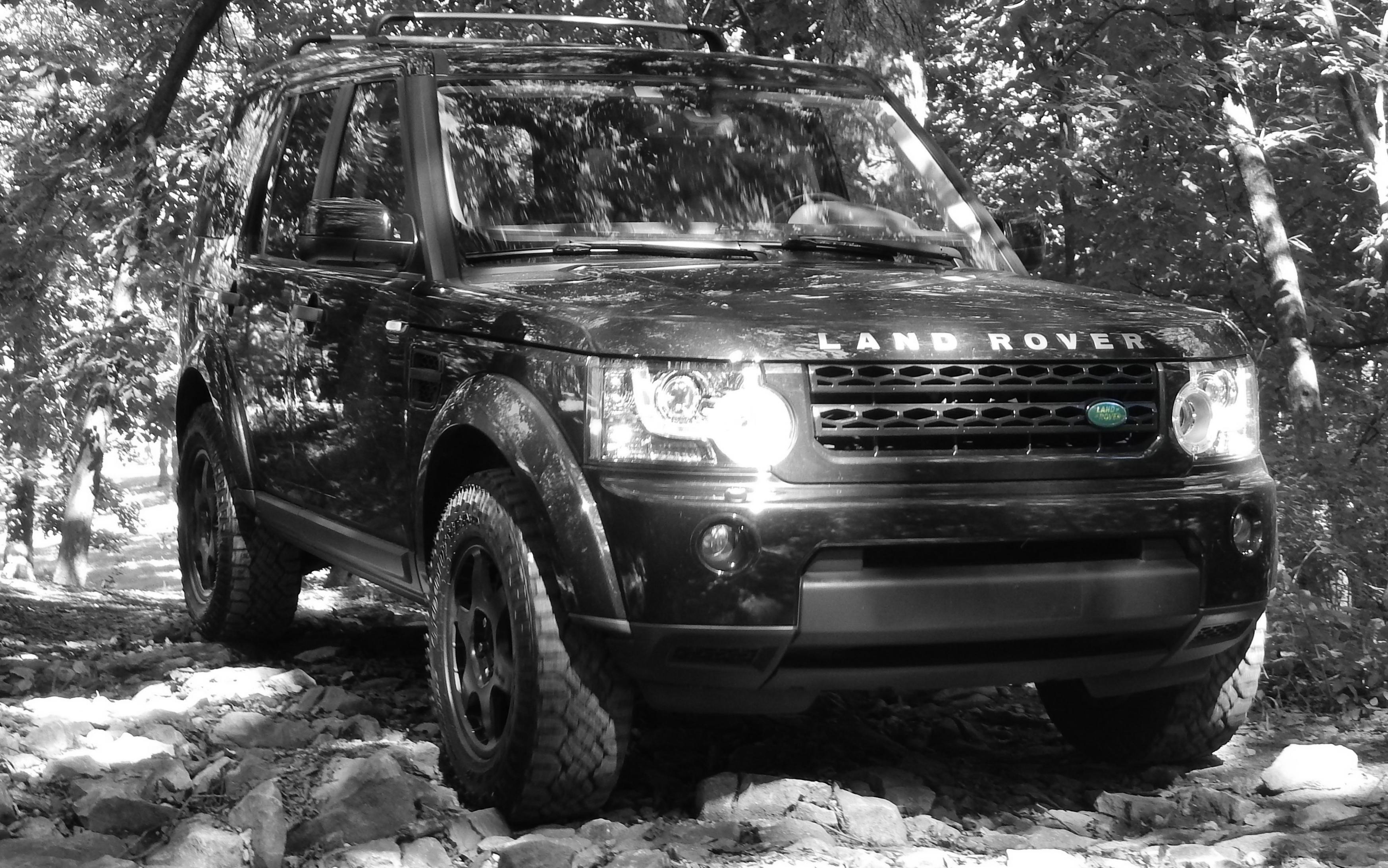

I have the Goodyear Duratracs in 265/656/R18 and I absolutely love them. I had previous experience with them on my Hummer H3 and had zero problems. The behave well on pavement, stick like glue in snow and ice, and they perform very well off road, even in the mud. An all around good tire and a good match for my LR4.
