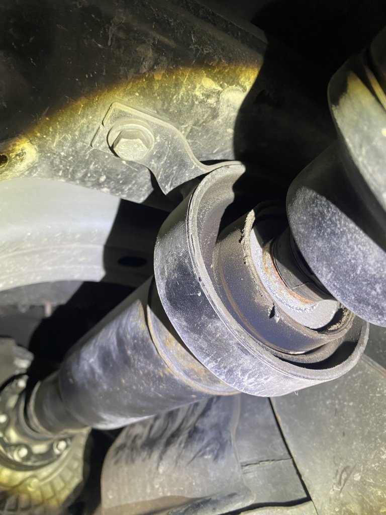

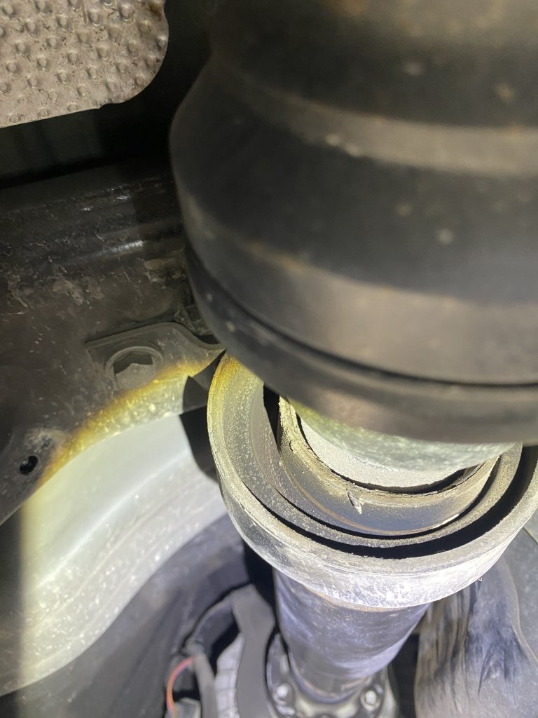

M32H32IS
Feb 8, 2022
182
59
Texas
The bushing on the center carrier hearing isn’t separated but it is sagging considerably and there is play.
I’m guessing this is the culprit?
Ordering the JXB, hopefully it resolves the issue.
