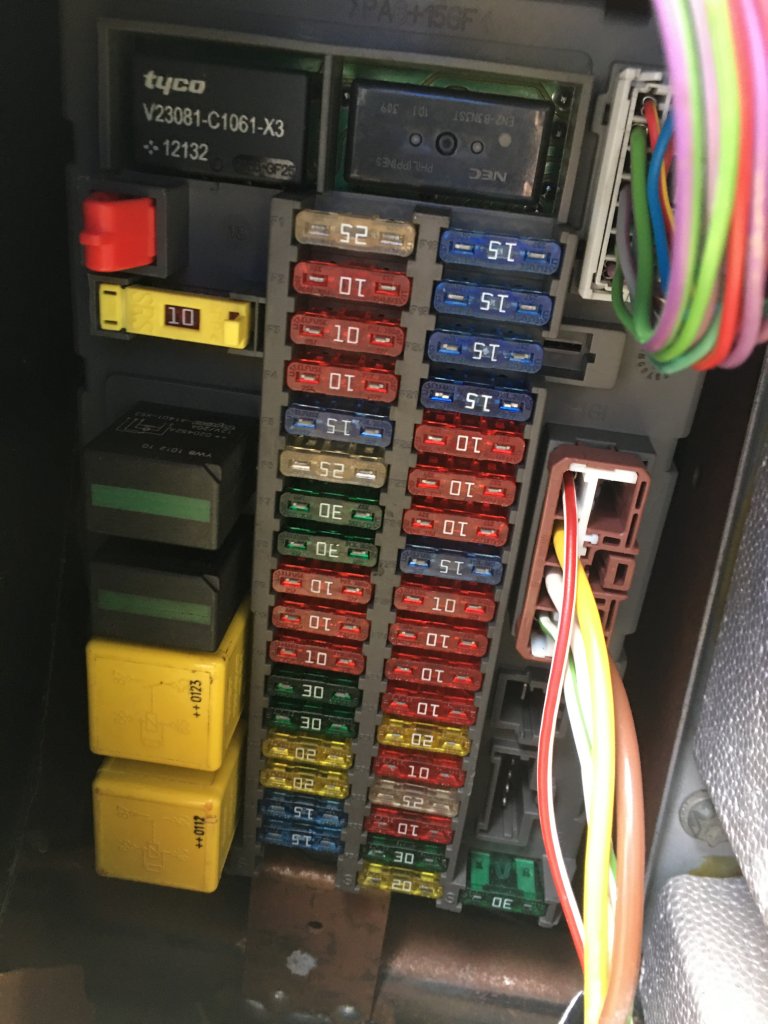

My rear fog switch has been ON since I bought the truck. No way to turn it off or on. Anyway, what do the rear fogs even look like in a 2002 Discovery II? Anyone have a photo with them ON?
Thx
Sean
The look like a second set of brake lights basically. Just bright red lights.

I'm hearing the click behind this relay. I cant find a replacement number. Any help would be great. Thanks.
Tyco V23081-C1061-X3

To close this out, I'm going to find a replacement fuse box. I think this is the only way to fix the fog light short.

Fog lights are normally in the bumper, not the ‘brake’ light.
Check wiring at light housings for corrosion, and clean up. More likely short location... and you’d still hear it at fuse.

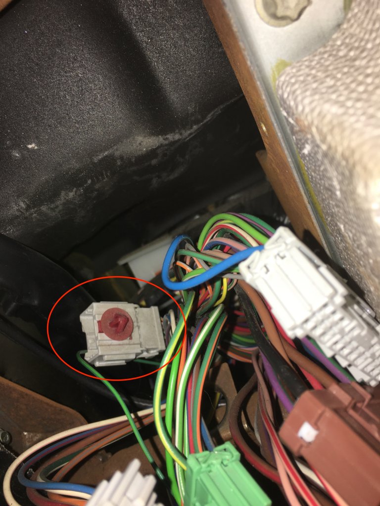

Somewhat unrelated, but I pulled out the fuse box under the steering column like the photo above, and I found a grey plug just sitting there. I circled it in this photo. Any idea on what that is?
