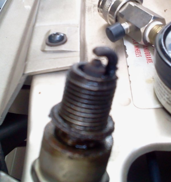

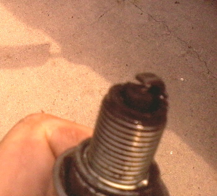

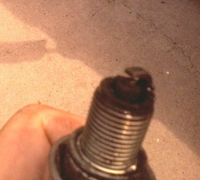

Just for the fun of it, I pulled sparkplug #5 to check its condition and do a compression check just to see if it might be an issue with the head gasket since I've had the cylinder 5 misfire code twice now. The compression on cylinder 5 is 129psi. The plug has a fair bit of carbon in it and was generally dirty. I would post a pic but afraid the post might get withheld again.

Cylinders 1,3,5, and 7's plugs were in way worse condition than the other side. The previous owner also had 3 brands of plugs in this thing and they were in nasty condition. The worst of them had some pretty serious carbon buildup on them. I will replace them very soon but just cleaned them up for the meantime.
