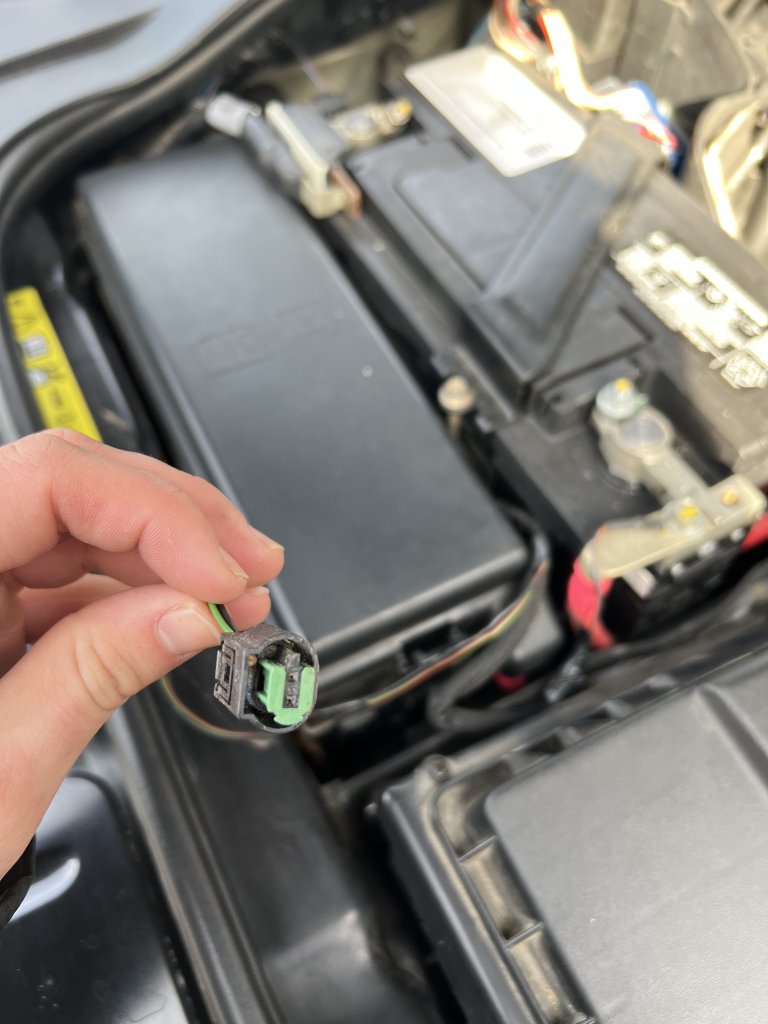

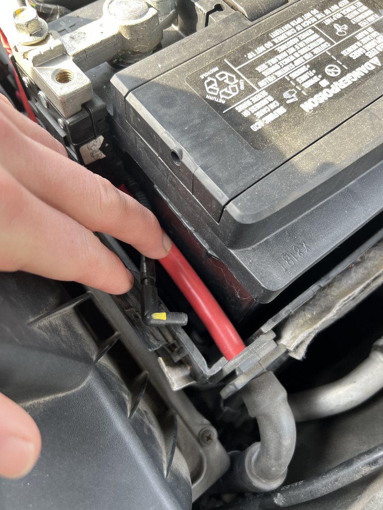

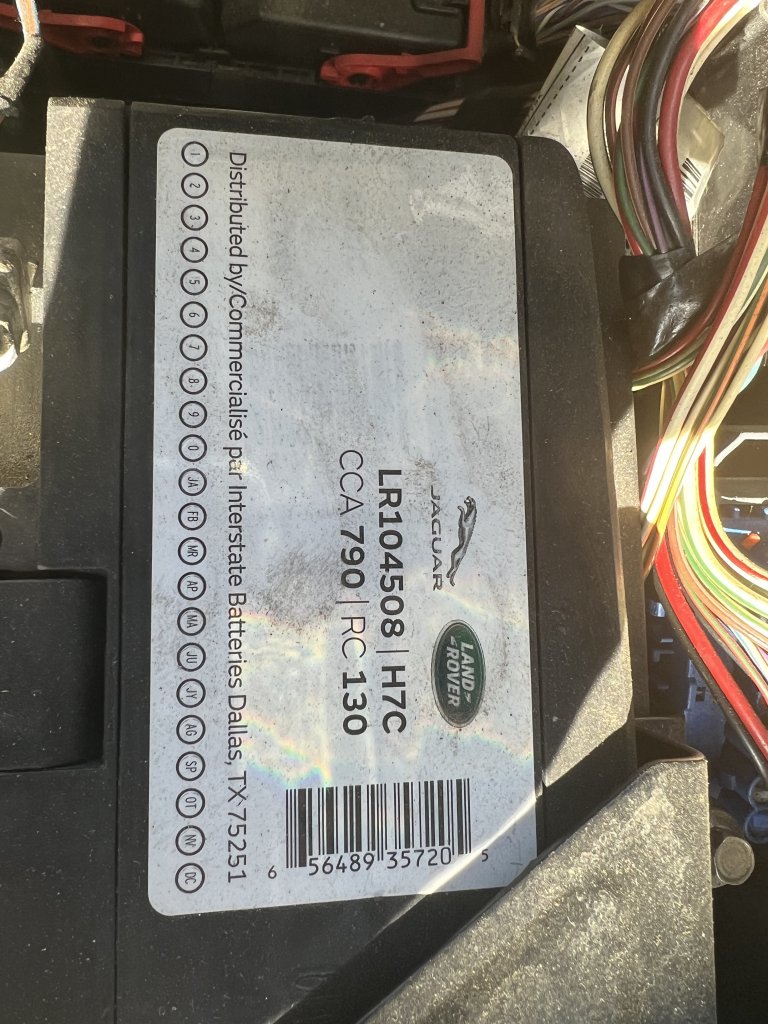

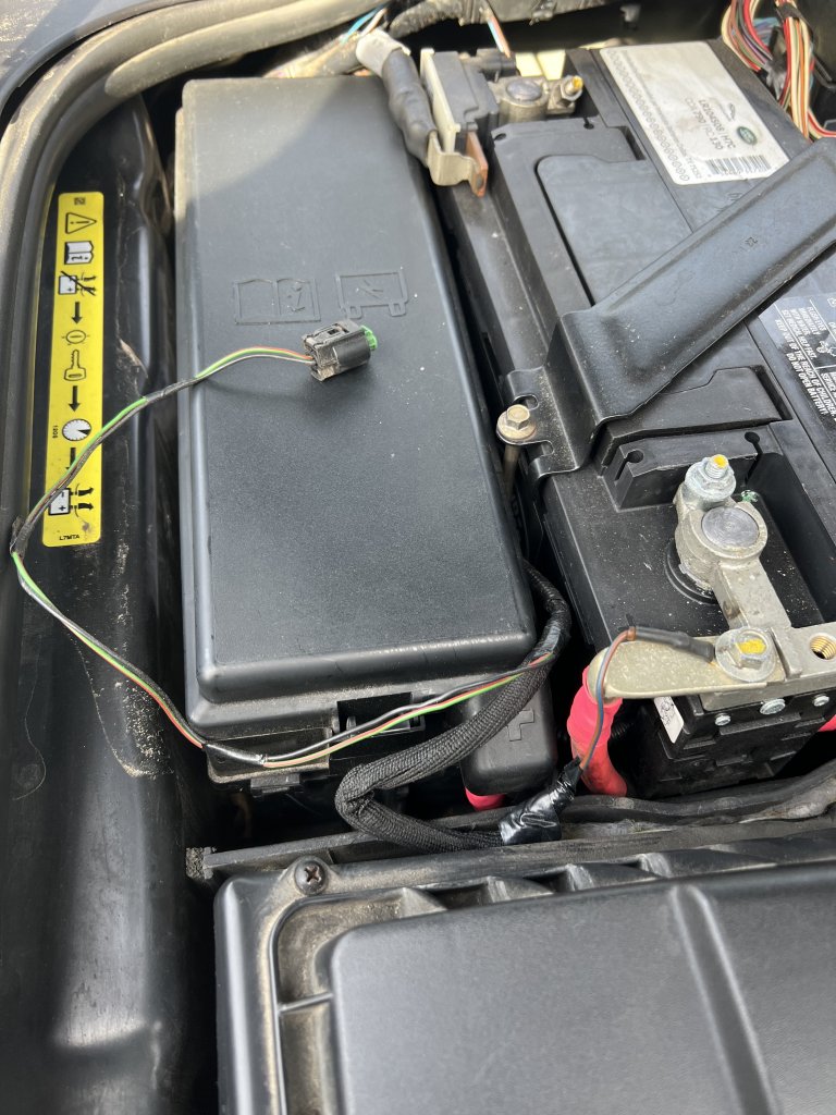

Went to inspect the battery, looks like JLR so I’ll have it tested tomorrow. On a side not, does anyone know what the green connector goes to? It was just hanging out in the battery compartment and not attached to anything. Also a hose there with no connection as well. Photos below.

The connector is for the transit relay.
Once the vehicle has the pre dilivery is performed, the relay is no longer needed.

Batteries on the LR4 don't usually last long. The original batteries on these weren't great and most people needed a new one at around 2.5 years. That was still within the warranty period, and most dealers replaced them with Interstate batteries. That's what was on mine when I bought mine at about the 3-year mark. I drove with that battery almost 2 years and 24,000 miles until it went bad and I replaced it with another Interstate. That battery lasted me about 3 years and 34,000 miles until I replaced it with an Odyssey. Now I regularly use a ctek on my battery and hope it will last longer.
This is all to say that, if that's your original or your second battery, it belongs in a museum. I can almost guarantee you that it's time for a new one. I joined this forum right when I bought my Rover and most on here at that time were still the original owners. I have never seen a "JLR"-branded battery posted here before.
