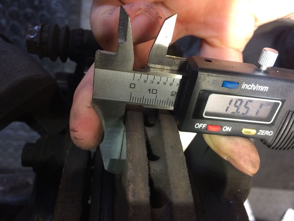

I have the car up in the lift now. Started with rear left and outside pad is in sad shape, but inside one doing significantly better. Measured the new rotor and it's 20.00mm on the nose and it is stamped with a min thickness of 17mm. The worst measurement I can get on my existing rotor is 19.51mm.
As a result, I'm inclined to leave the rotors alone despite some slight grooving. Car has 23.5k miles on factory brakes.

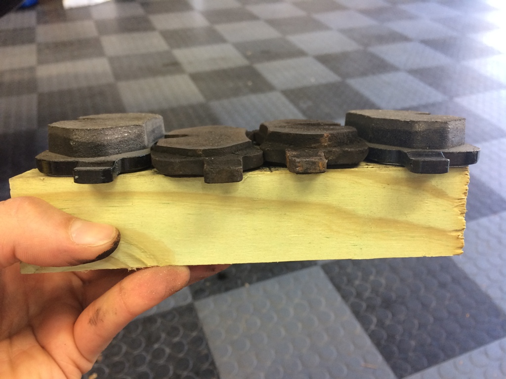

Here are some photos of what I I mentioned. On the comparison of (rear left) pads, the most worn is the outside pad, with the inside pad having the sensor and not having tripped it yet. Obviously on the extremes are the new pads for comparison. Again, 23.4k miles about 65% highway driving.

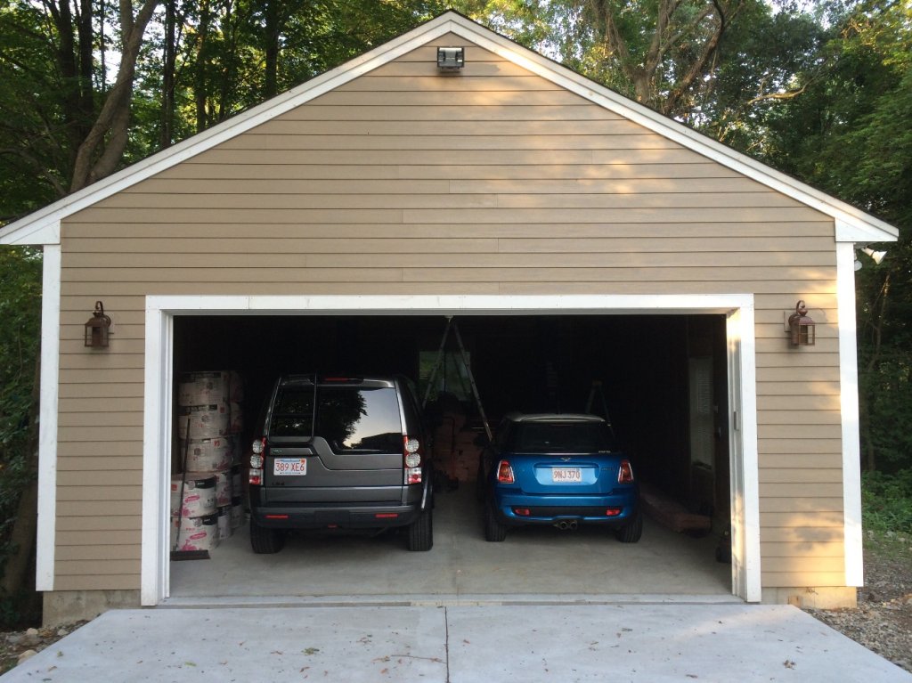

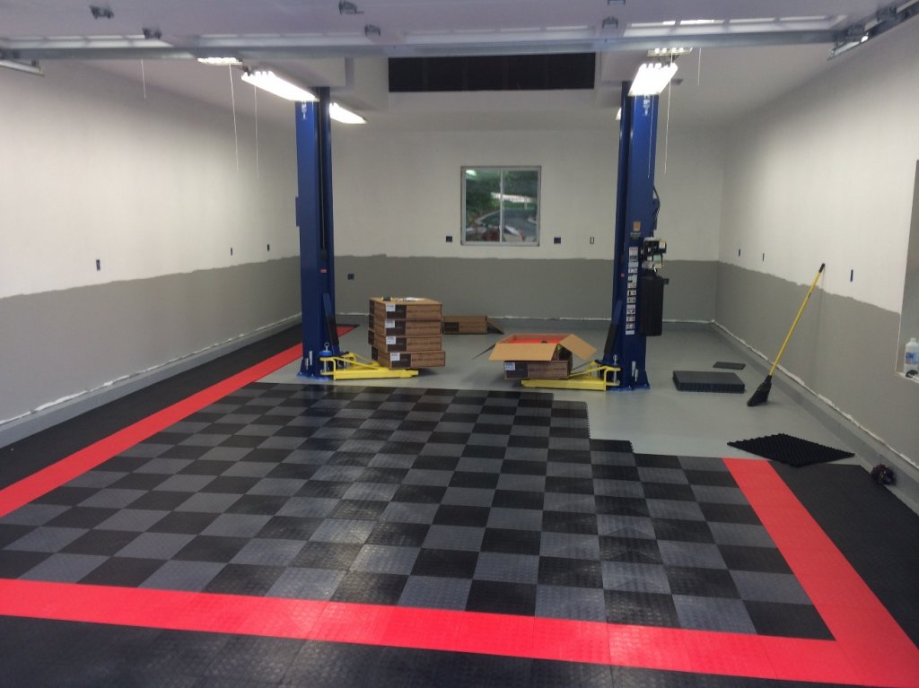

Even though it was down 2 years ago, my 300+ photos are a mess. Here are a couple of the garage in various states of completion. I have not yet taken a photo of it totally done because there is always a project going on making it messy.

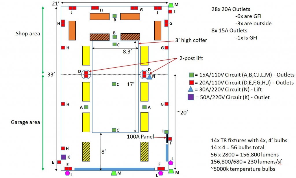

For your purposes, you may benefit more from my electrical schematic, which shows the location of the lift and the coffer (it's missing a 2nd 30A circuit I installed on the other post, so that I could plug in a 240V heater). Note that the lift is set 20' back so that the garage can be used as a 2-car garage with room left over for projects, but when the lift is needed there is plenty of room to get around. I only have 3 cars (and two live in the 2-car garage attached to the house), so typically there is only one car there.
The garage is 22' wide by 34' deep on the outside.

That is fantastic. I'm worried I might not have enough depth for a 33' deep garage, though--I have the width for a 2.5 car garage.

Back to the brakes... That is a significant difference in pad wear from the inner to the outter pad.
Make sure the caliper guide pins are thoroughly lubed. Also did you inspect the caliper piston boot for rips?
I have done (myself) the brakes a total of 3 time. I always get consistent wear, within 1mm, for the inner and outter pad (front or rear).
Seems that there may be some others factors going on here.
