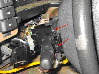

5. Access to two small screws used to secure the switch housing to the steering column assembly is now gained. See picture. Remove these two screws.
