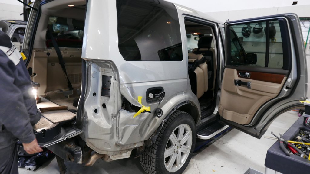

Have you replaced a lot of the suspension and such? If you have, it may be worth an engine. If not if it was me I would part the beast out and buy the best condition 2013 I could find. I bet I could part out a LR4 sans engine and walk with north of $10k.
When mine got smacked a bit in the rear a OEM rear quarter panel alone was something like $2500 CAN.
