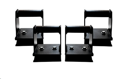

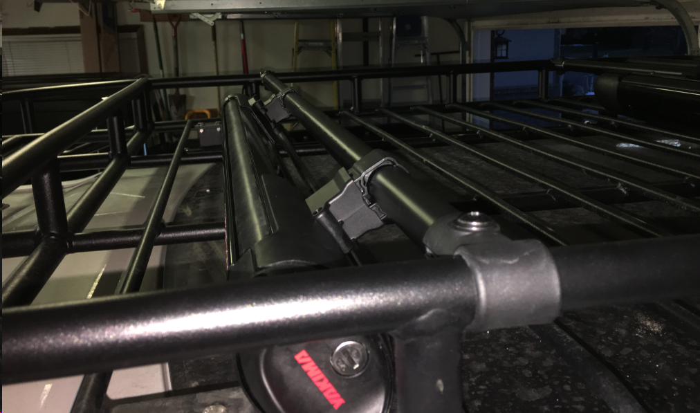

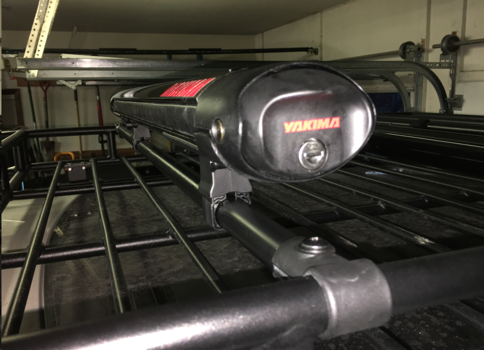

So, I knew I needed ski racks that would allow us to fold them down when not in used, I also knew that any cross bars that I added needed to be flush with the top of the rack as it sat. After searching and searching, I found these.
http://www.etrailer.com/Accessories...tml?feed=npn&gclid=COLx5LLulNECFZ2CswodyAkCrA
Now, these are for the yakima branded basket which is only 36" wide. The MegaMule is 48" wide. I ordered these and then picked up some 48" yakima round bars. Cut about 1/8" off of each bar with the sawsall, drilled some holes and mounted them up.
And, a video:
In the end, I spent 3 months hemming and hawing over what to do. Just hoping to help out the next DIYer who refuses to settle for just what the market provides and is ready to think outside the box a bit.

I just got a "stormtrooper" too. I don't have a lot of clearance in my garage and I ski a few times a week and have been worried about what to do rack wise.
How's the wind noise on that setup? Out in the west here I'm normally doing 85 on the freeway and have that as a concern.

The wind doesn't seem to be any worse than it was before. I would like to think that the wind fairing on the mule is helping with that.

Season #2 with the same setup, don't think I could have gone any other way and everything still functioning well... Now to figure out how to get a Denver Outfitters Rod Vault on there. However, we have a home remodel coming sometime in the next couple years, raising up the garage doors is one of my "must haves".
The baja rack is great, functional in so many ways and also give a nice look that really sets the LR4 off from everyone else's. There is a slight increase in wind noise and I'm sure a slight mpg reduction. I feel like the wind noise issue may be something wrong with the sunroof sealing or draining system, just haven't had the time to troubleshoot it.
