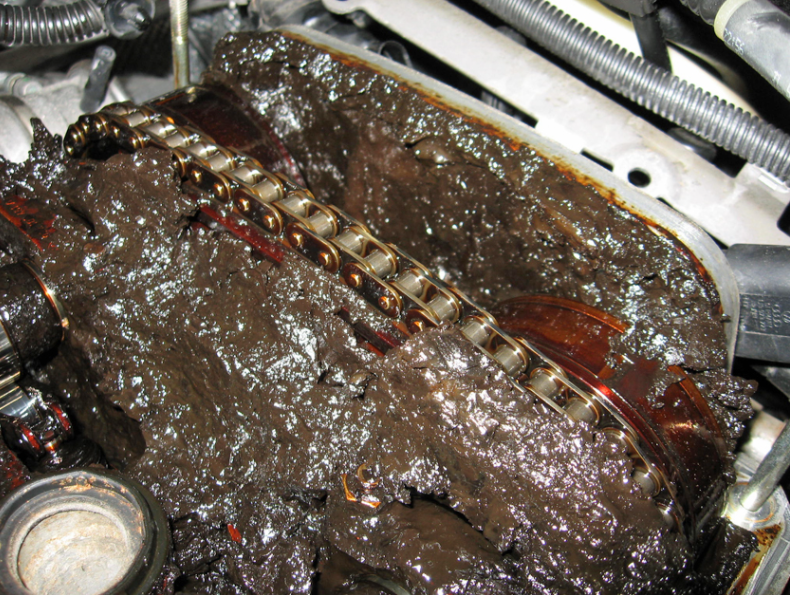

years ago... Oil viscosity is spec'd at around the boiling point of 100C so either side of this is fine but the engine is most efficient near the boiling point. Keeping the engine temp lower is going to increase the acids sitting around in the oil and it will eat up your TBN quickly. Since you change at 8k kms as you say this is not a concern. (can you Americans please join the rest of the world and convert to metric?) please lol). Perhaps I am still paranoid from the sludgy engine debacle from the last 20 years or so. The temps in the valvetrain just didn't get hot enough. I also drive around in the freezing cold and at -30 I appreciate a warm running engine lol.

Good points. My discussions with Andial were back in the late 80's, and I was running M1 then, so I am sure BIG improvements were made. I use AMSOIL in my 930 and L322, so I am really not to concerned about oil temps hitting 220-230 in either of those cars. I just don't know the quality of the JLR Spec Castrol that I use in the LR4. Working on the metric!
