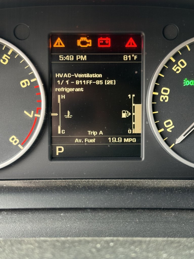

AC not cooling - B11FF-85 (2E) code
M32H32IS
Feb 8, 2022
59
Texas
Apparently there’s an issue with air conditioner refrigerant pressure according to my GAP tool. Any idea what causes this or potential solutions?

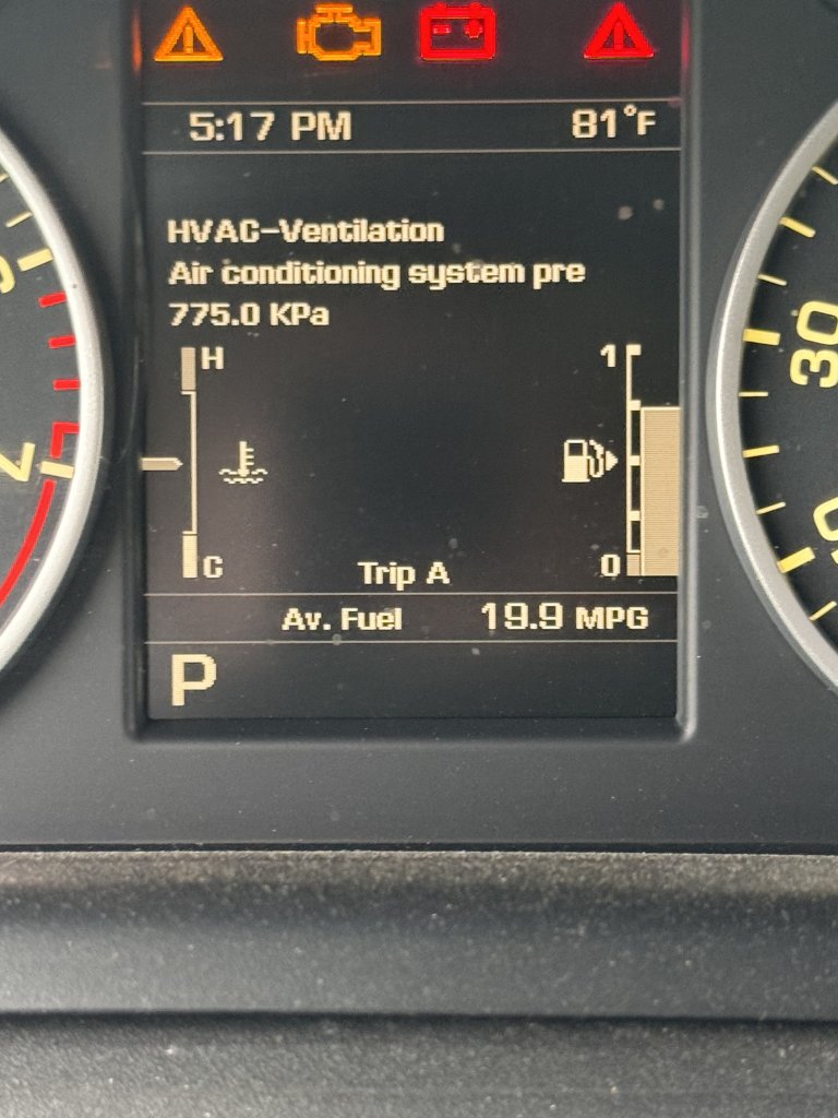

You can use the GAP tool to pull up the refrigerant pressure. Should help you diagnose a bit more.

My pressure reading according to GAP

For that DTC, a few things need to be checked.
Test the refrigerant system for proper freon charge.
Check the condenser and hoses for damage or restriction.
Test the air conditioning fan for correct operation. With the engine off, should spin with some slight resistance. With the engine running, should have good air flow.
You can install a new refrigerant pressure sensor as necessary. Those rarely fail though.
More than likely, you will have to install a new HVAC control module.
