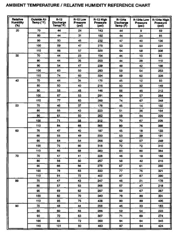

I don't know what size cans you were using, but if they were anything other than 12 oz, then be careful. Even with the rear A/C fitted, the total capacity of the system is just under 32oz of R-134a. You definitely don't want to overfill, and therein lies the rub. You really don't know how much refrigerant is in the system (even by reading the pressure) unless you evacuate the entire system and refill from scratch. If you don't evacuate the system, then the best you can do is guestimate by using a pressure/temp/humidity chart and the manifold gauges.
