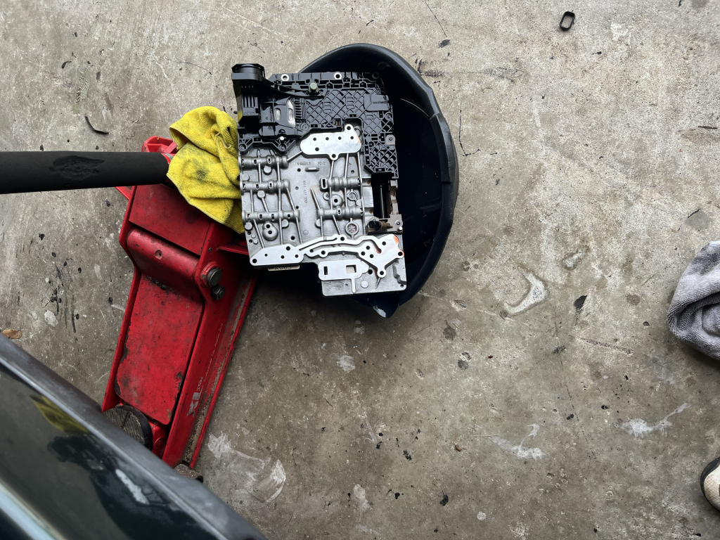

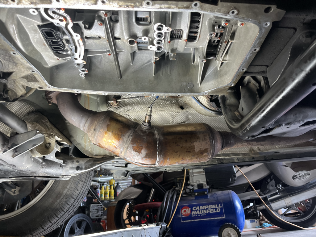

I've been there twice; an 08 LR3 , and a 10 Range Rover both ZF 6 speed trans with 200,000 miles. The 08 was a simple filter/fluid change.
The 2010 had black trans fluid, with slipping, and shuddering. I replaced the 5 seals above the Mechtronic unit. I did not have any tranny codes, therefore I did not spend the money on the solenoid kit. I also replaced all the tranny fluid 5 gallons (Valvoline MAX life ATF 1/3 the cost of the Gucci ZF fluid)., at the radiator cooler up front. And added a Ford friction additive recommended by YouTube transmission expert Gary Ferraro.I had complete success, she performs like new! If you wish PM me for more intel. Good Luck!View attachment 22661

In the minefield of life, look for the footprints in front of you. I've had two ZF6 speed transmissions with 200,000 miles. One was a simple fluid/filter change. The other had slipping and shudder, with no transmission codes. The slipping/shuddering transmission also had black fluid, but did not smell burnt. This is the path I used for complete success, shifts like new again:
1) Replaced all tranny fluid, 5 gallons at the tranny cooler radiator. Valvoline Max life ATF 1/3 the cost of ZF fluid.
2) New Filter
3) Ford tranny friction additive, based on YouTube tranny expert Gary Ferraro's wisdom.
4) And most importantly replace the 5 Mechtronic rubber seals.
Please feel free to reach out to me for more intel. This was not an easy or fun experience. But it is a complete success.
