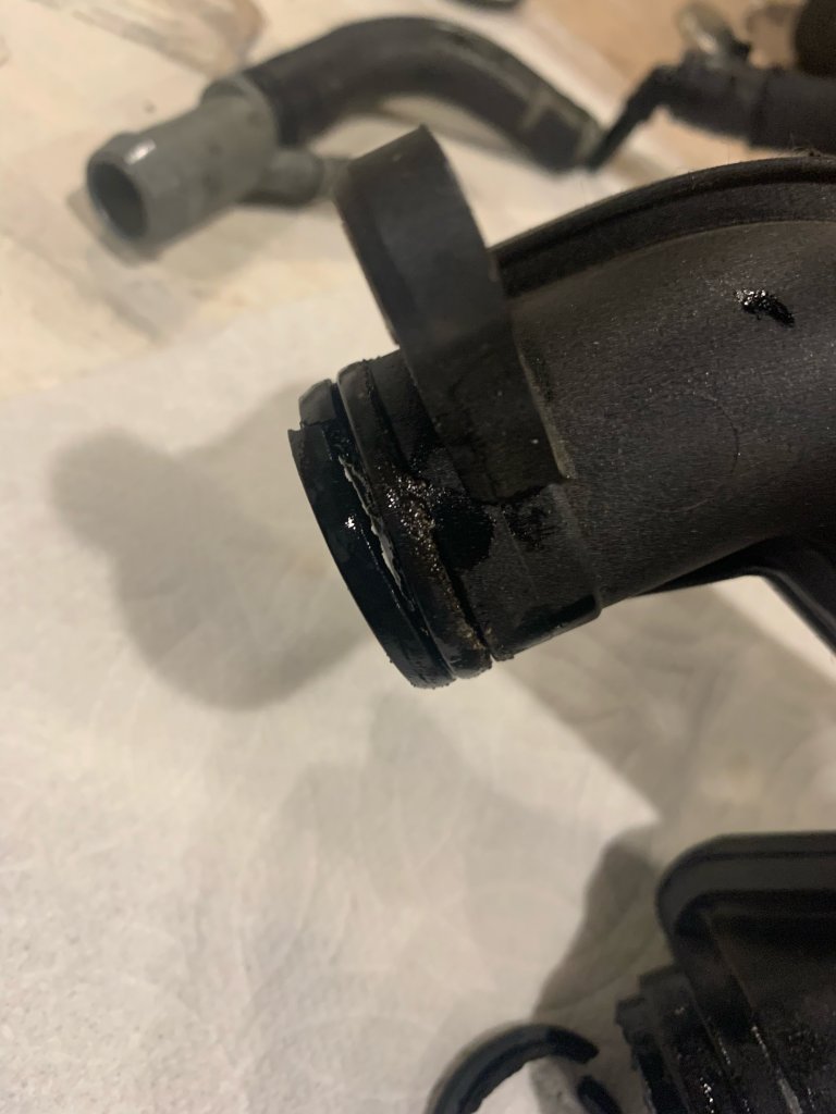

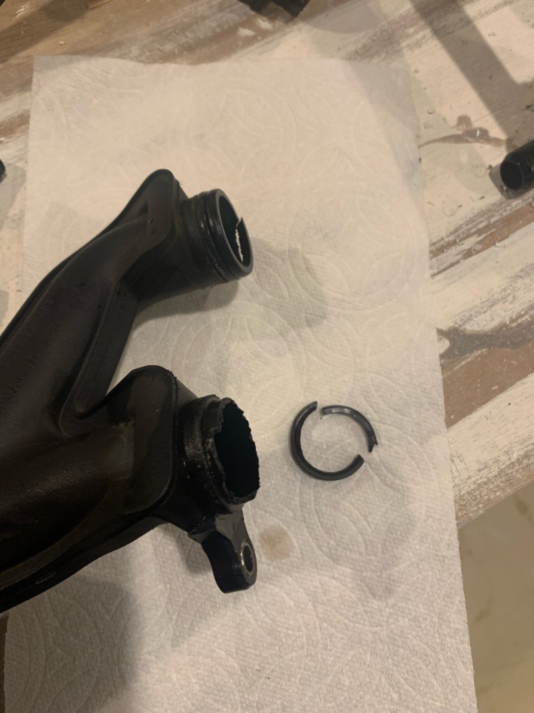

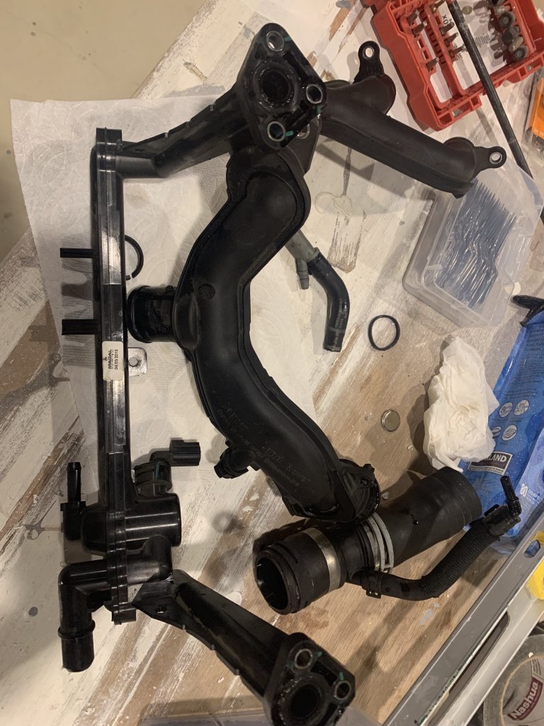

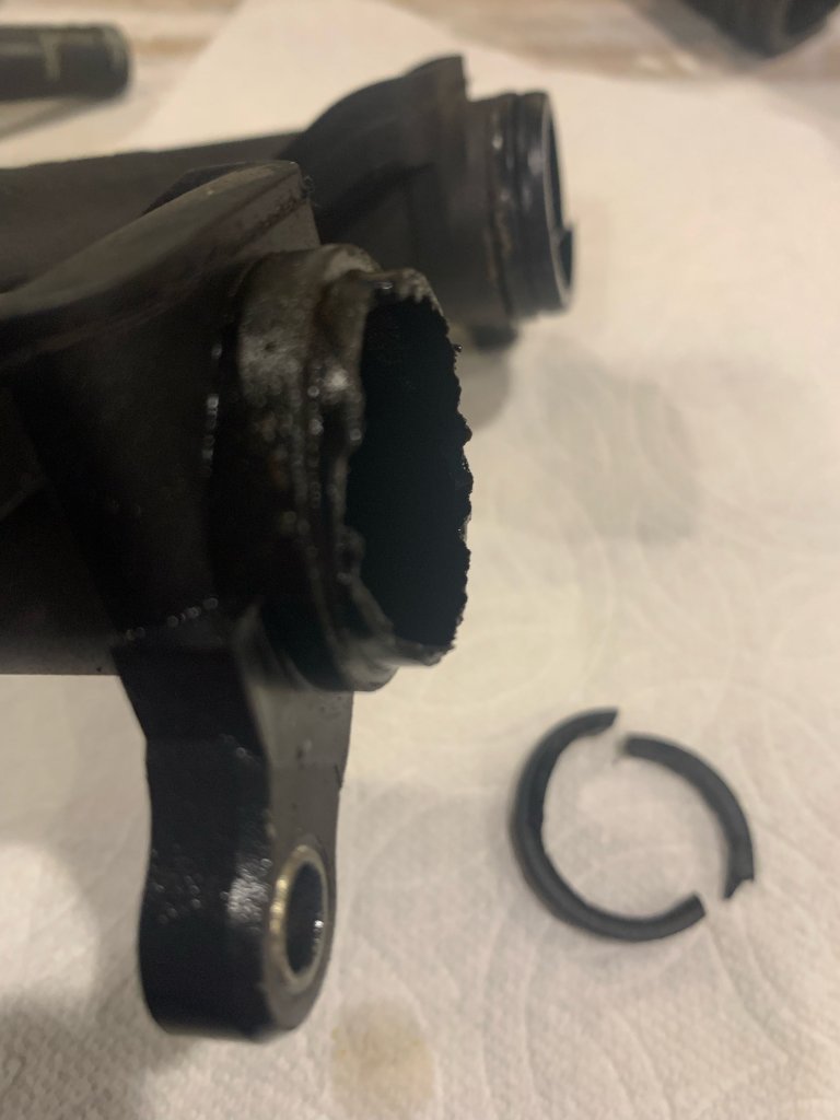

Okay, hopefully another one saved from oblivion. Just had Biggs in bellevue do the front and rear pipes. Honestly, I don't know which is which but assuming the front is the one with the problems? Here are pics. Curious to get your thoughts. Not worried if i replaced them for no reason as the peace of mind was worth the $1500 bill.

In your first photo, the rear crossover is the one on the left.

Yeah.
Seems like that is where the front has issues a lot of the times. People report the inlets on the front crumble apart when they remove them.

well, they were definitely crumbling. The tech put the pieces that fell off in the box with the parts. Our LR4 has 54,000 on it. So parts were in state of decay at what i would consider low mileage. That said, it is six years old.

They are almost surely brittle at this point. When and how they choose to leak depends on a multitude of factors. Vibrations, torque while off-roading, temp swings, etc. If you plan on keeping the car for more than 15k miles go ahead and pay the money. My 2014 v6 pipes were toast at 55k. Had not sprung a leak but disintegrated on removal.
