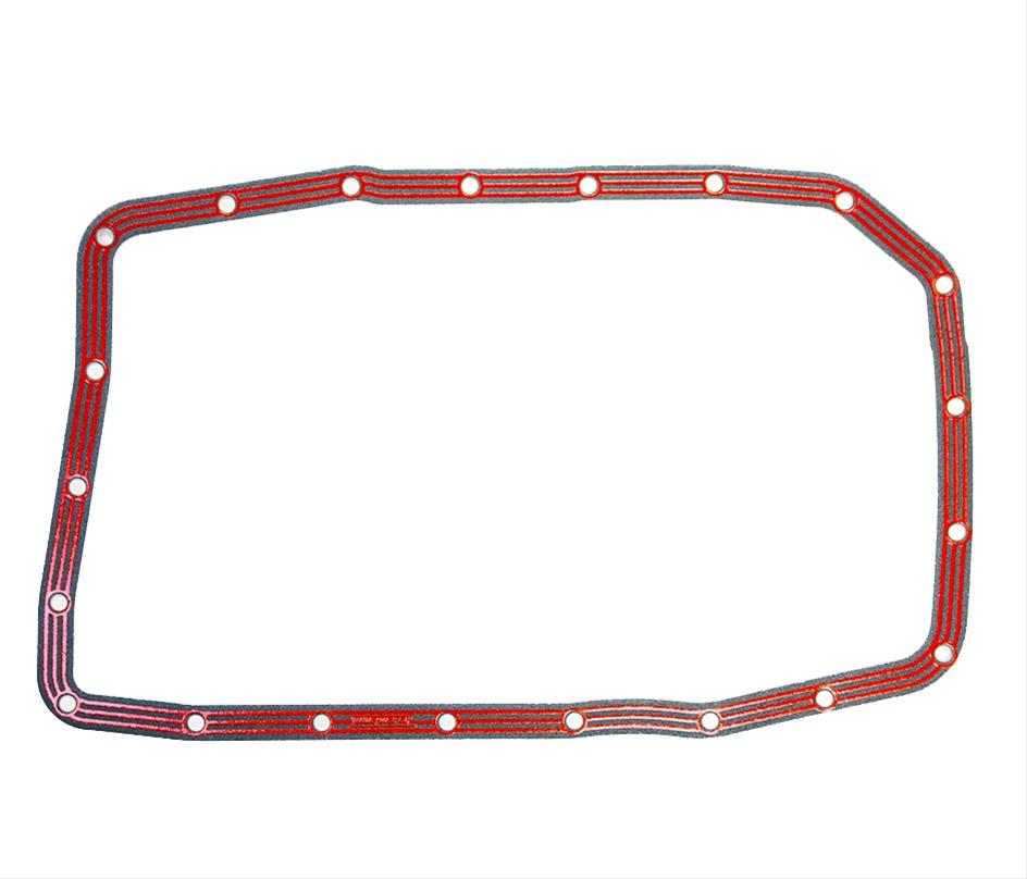

Finally, the trans pan gasket. I was going to take my chances with the gasket supplied in the Rimmer kit but @Daniel Atkinson came through just in time and pointed me to this instead: https://www.summitracing.com/parts/LUB-LLT-F6R80
I am so glad I ordered this because the flimsy rubber gasket that came with the Rimmer kit didn't look great. This gasket is awesome and doesn't need any sealant.

If there is one key takeaway that I would emphasize, whether you do just a fluid change or end up doing the zip kit - absolutely use the lubegard trans pan gasket rather than the junk that is supplied with the conversion kit. An extra $20 is worth to prevent seeps and leaks.
Thanks for all this info, and the link to a proper gasket! I've not yet done the conversion to the metal pan with separate filter, and one of the reasons I was reluctant was the crappy paper gasket supplied. I've dealt with those in the past, they are too leak-prone with a stamped-steel item like the aftermarket pan. I knew it would need sealant to not leak, and I hate smearing sealants on paper gaskets, as it is a massive PITA to clean off the next time.
The LubeGard LLT-F6R80 filter claims to be aluminum core and appears to have silicone beads silk-screened on the faces (both sides, I assume) which is PERFECT for this application. No sealants needed, and it also shouldn't stick to either pan or transmission flanges.

Ya, agreed. This gasket looks 10x better. I really had to use quite a bit of sealant this last time and I know it is going to suck to redo it again. But brake cleaner works well. Just such a messy job. Wish I had seen this a few months ago. :D
1,694
I just ordered this gasket. I may just redo the fluid and take the pan off one more time (third time's the charm) and change to this gasket and a new filter. Fluid should be well flushed by then.
