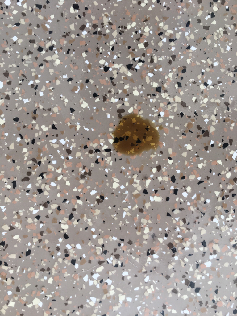

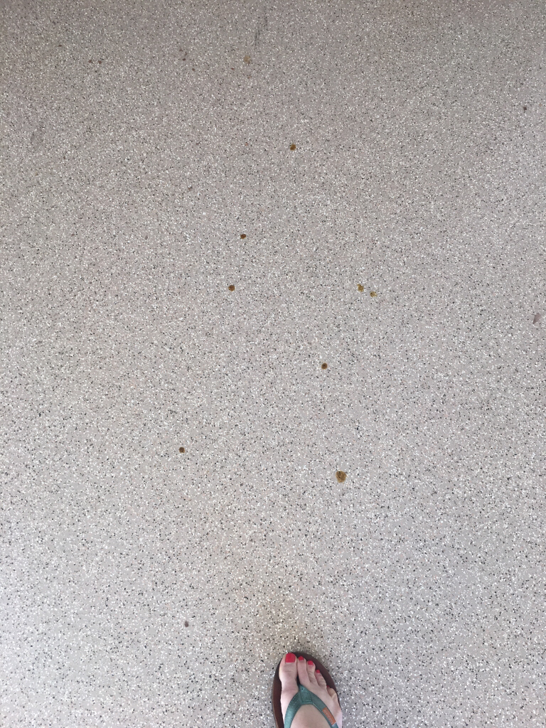

I have an '06 Range Rover with 125K on it. Six months ago I moved cross country and had the car shipped. Our house has epoxy finish on the garage floor (first time I've had that), and I noticed a very small leak. Brought it to the new dealer right away (my main concern was that the shipping company damaged it because it seemed like the driver had messed with the suspension to get it fit on the bottom row of the truck). They said it was residual from recent oil change. Sounded fine enough. they were out of loaners, and car was serviced the week before I shipped it, so I left.

Well the leak is back now too.

That's the leak - again it had stopped after the O ring was replaced, and started again either yesterday or a few days ago.

Apparently noise was heat shield scraping against wheel or brake- which really ****** me off because (now that I know what it is..) I could sort of see it hanging somewhat low when I heard the noise months ago before all this work. And now leak is engine oil and not differential fluid. I suppose it could perhaps be a new leak - but it looks exactly the same.
glad you found your scraping noise and that it should be a cheap fix. Oil leak, well almost all vehicles will eventually leak oil.
