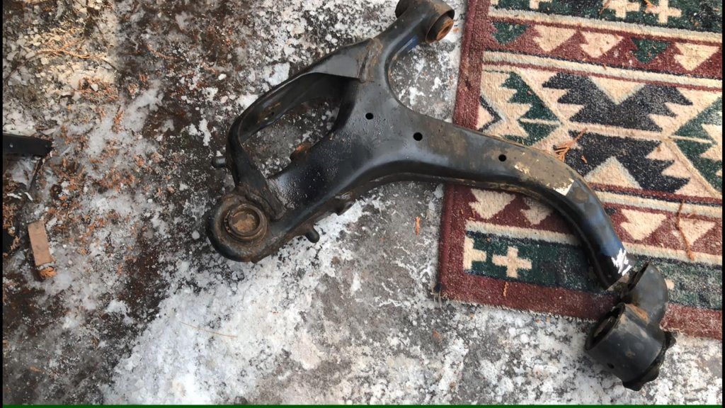

I did the front arms, in the winter, outside, in about 5 hours. That included new rotors/pads, one tie rod, stabilizer sway bar end links, and one side stabilizer sway bar mount.
Grinder with cut off disks, and sawzall with Diablo CARBIDE blades various lengths. You need the carbide blades to cut through the bolts. Also handy to have a large 3 jaw puller in case the axles are stuck in the knuckle.
Your alignment may be off enough to throw the car into panic mode. Where all the warning lights go on and the car lowers to the bump stops on the drive over to the garage. Shutting it off and restarting will air it back up so the alignment can be done.
Being in Texas you may get lucky and everything just comes apart as it should. My arms were replaced 4 years previous, I was able to get the front bolts on both sides out by hitting the bolt with a metal rod/hammer. The rear bolts there isn't enough room to pound on them so they needed to be cut. Cutting the arm helps to gain access to get tool into area to cut the bolt.
