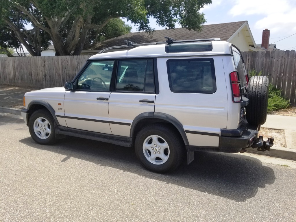

My 2001 Disco (130K miles) basically still kicking it EXCEPT after recently getting the head gasket changed (where the local mechanic that I have a good opinion of talked me out of doing more to the engine while in that state of disassembly because it was working fine, and scoped the cylinders prior to putting it all back together) now can't get the SERVICE ENGINE light to go out. My plates expire this month, and I can't get a smog cert if the light is on...
The code points to, and mechanic says, that NOW there is enough of a leak past the cylinder/piston ring that it won't clear. Spent ~ $2,000 (had some other work done) on the HEAD GASKET job, that now is all for naught. Getting quotes of upwards to $4,000 to fix. Like I said, seems to run great (and the light will sometimes actually go off, but not enough to pass the CA Smog test) and I love my Disco. Any thoughts other than spending the $4k on my $2k valued Disco?
