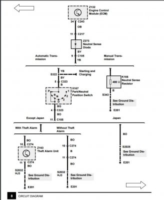

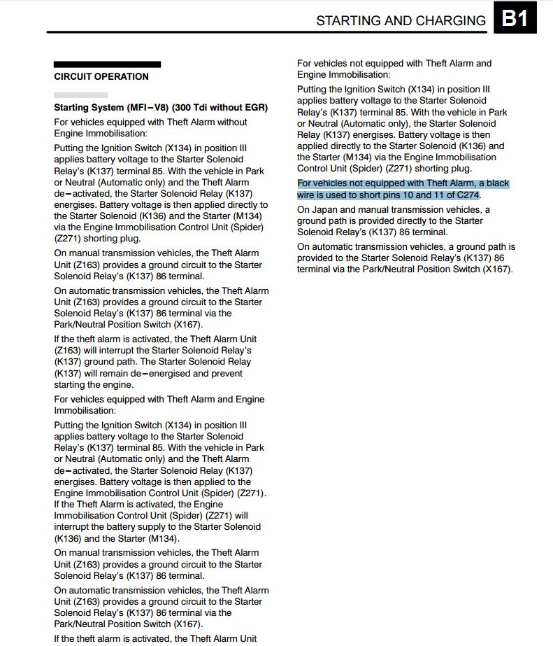

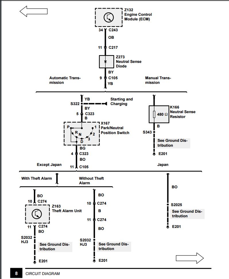

Arm Chair Wiring

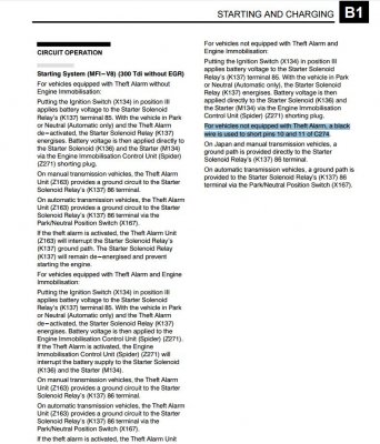

So, Doing some arm chair engineering from my desk today.
According to the electrical troubleshooting manual...
If I jump the black/orange wires... it should in effect bypass the starter killing? Is that a correct assumption?
I also read that you can do a cold reset by touching the battery cables off the battery? I will try anything.

Well it's been a while and I've managed to sort out all the issues with a sweet $500 land rover. I figured out my alarm issues by what I believe was bypassing the alarm unit. Since I do not have a key fob to reset the alarm and there is no way in hell I will be taking my rig to the dealer. By researching the wiring diagram, by connecting the 4 black/orange wires in line, this effectively supplies ground to the fuel pump and coils thus removing the alarms ability to disable them. This worked for me and my rover now runs perfectly with the key, no push buttons. I no longer have power door locks though which is a small price to pay for a fully functioning vehicle.
