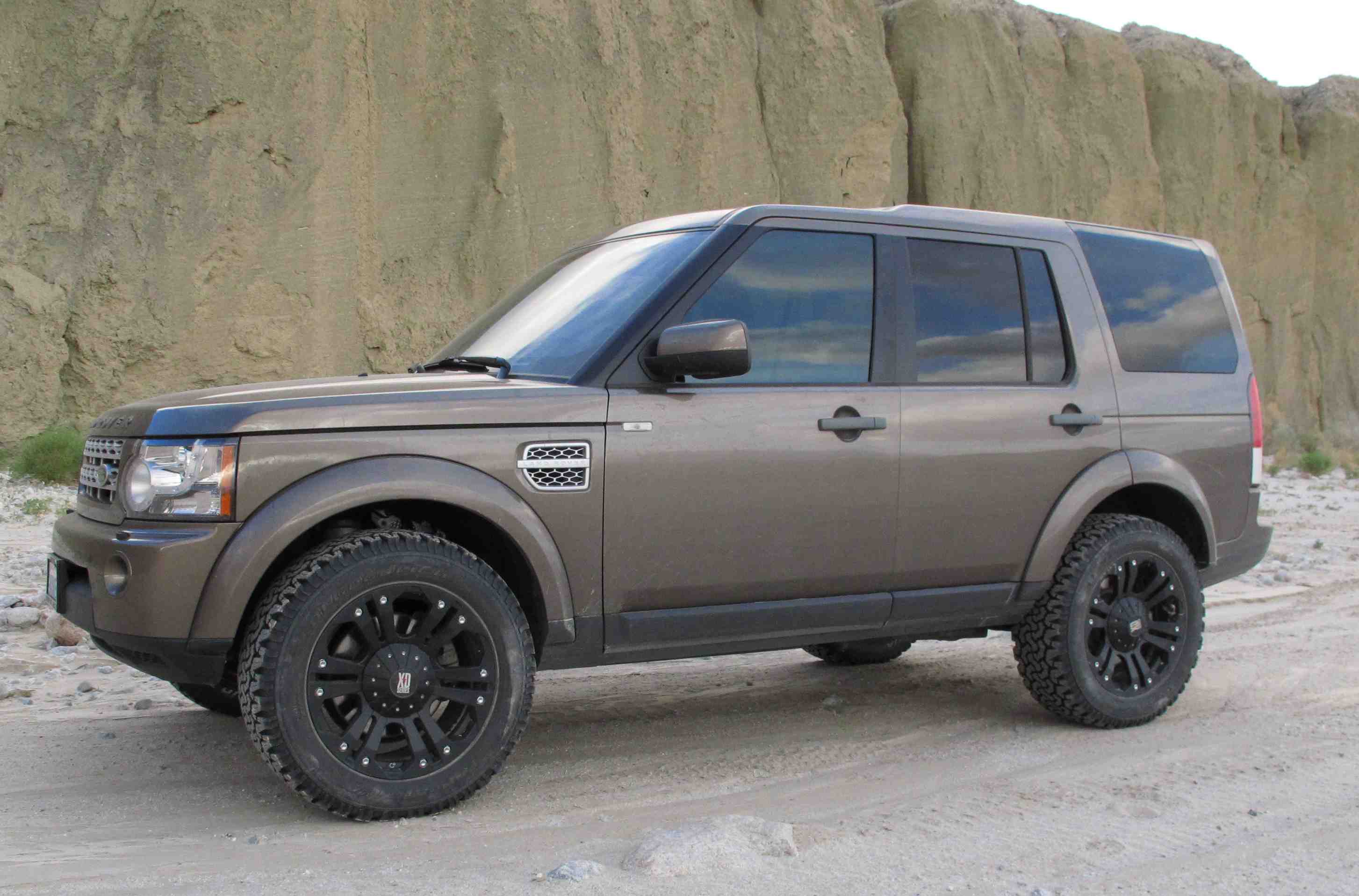

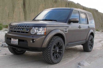

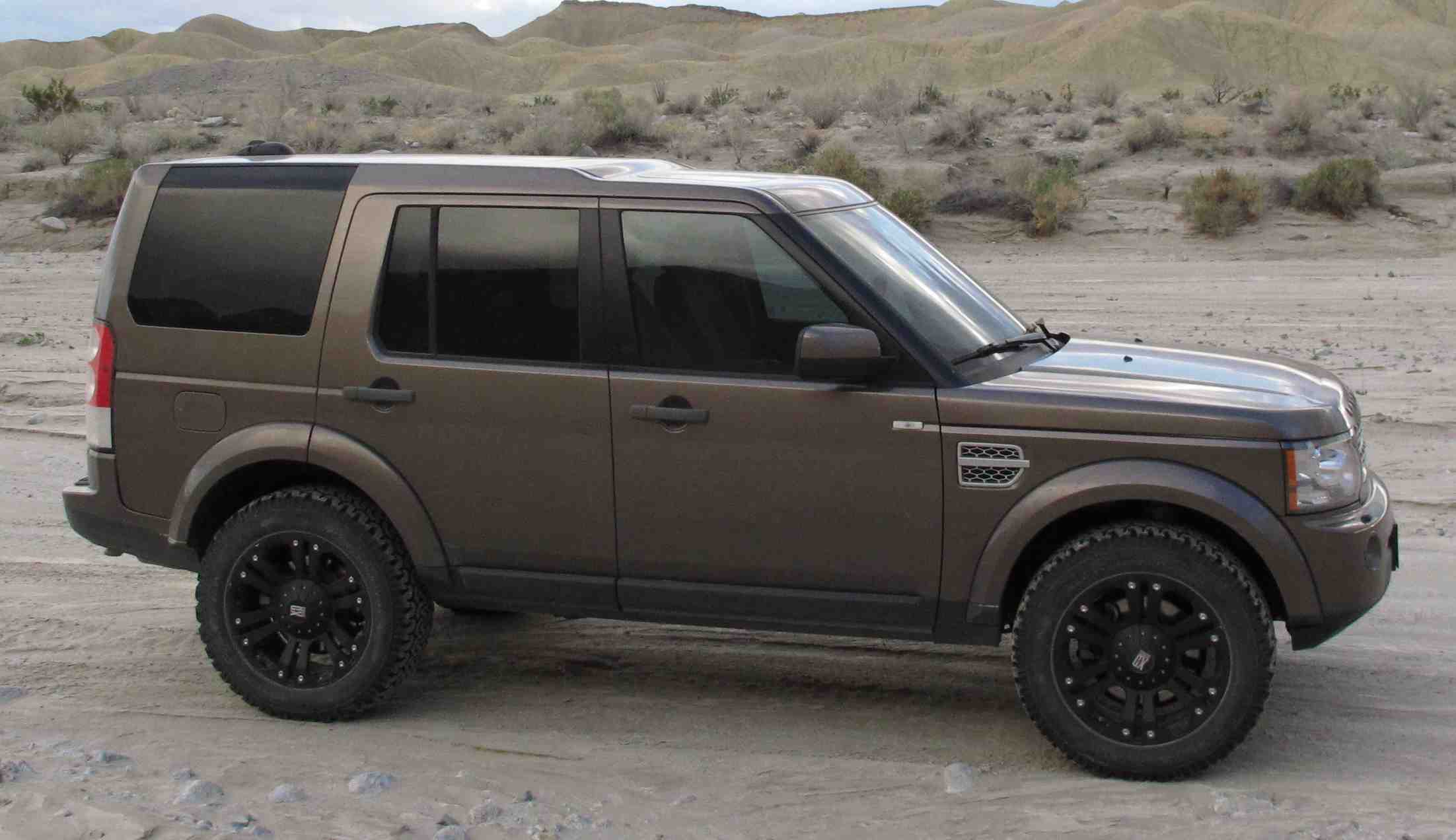

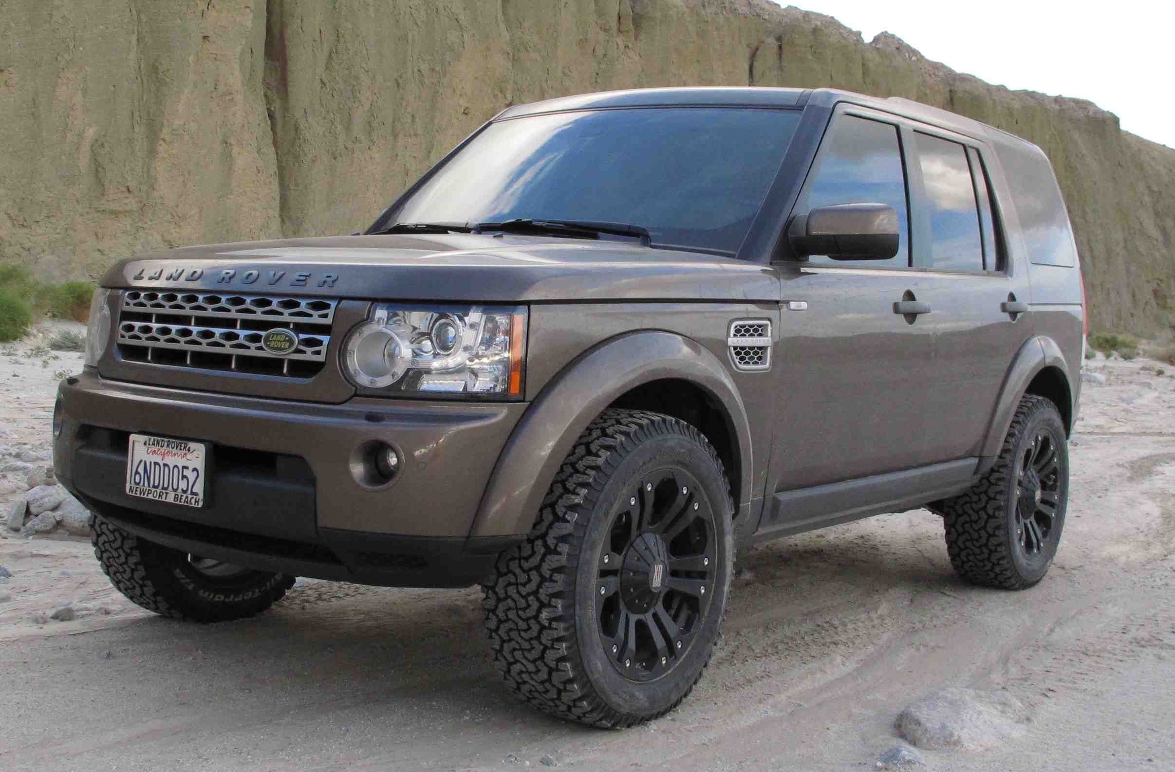

I have kmc 20's with 285/55 r20 bfg ta/ko
they are 32.4 and will only work with the johnson rods lift plus frame cutting and plating. I did this for @150$ and I am very happy. No more frame rubbing and the weld and plate look better than before because that corner is cut off and a flat plate is in its place. Land Rover ok'ed the mod and I am very happy with the wheels and tires. They go over anything!

here is a pic check my prof too.

I have to admit it actually looks decent however I still wouldn't recommend that mod to anyone because the tires will rub at full stuff and on the bump stops.......Love the color combo though...If I were in the market for an LR4 thats the color I would buy!

So, basically what you're saying is that the 18X9's will most likely fit at zero offset, with a 285/60/18 tire that's only 31.5" tall. I'm shrinking an inch of diameter from what you're running and have what looks like the same offset as your KMC MONSTERS. Maybe a Rod Mod, but all in all it's feasible.
