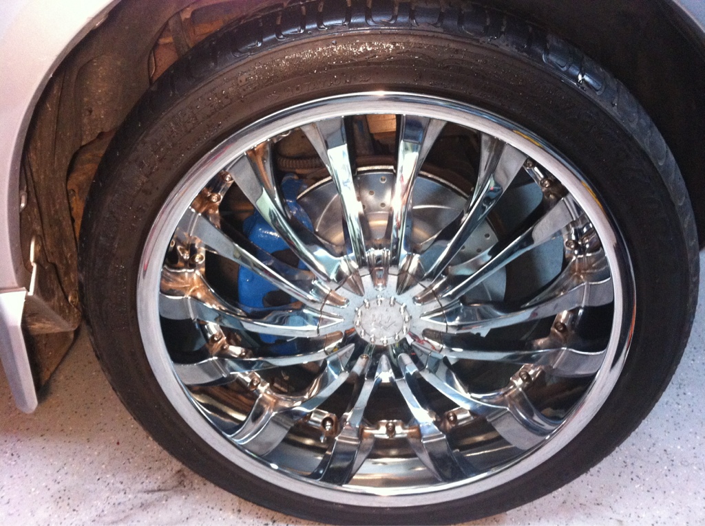

I just put drilled and slotted rotors all 4 corners and ceramic pads for low dust i just beveled the sides of the pads more for less squeek ing didnt come with sensors but those are dummy lights anyways. It was about 400.00 so far so good
Also when doing your brakes use a products like posi quiet on the back off the pads it will help maintain contact and wont vibrate this and beveled edges is why pads squeek well that and if you have glazed the crap out of them
Is that a 20" rim on an LR4 or something? ...22?

Its a 22" and we have our lr3 just for town driving because i have a new Bourn so our f350 that has 37" tires and 12" lift is a pita to lift baby into and my bush rig bronco 2 on a 1ton chasis and drive train with 36" super swamper boggers are for off roding if you are meaning why i have chrome on my lr3
yeah that's what I meant....but what about that mudflap; it looks like it's the same color as the body making me think it was an LR4. Custom job?

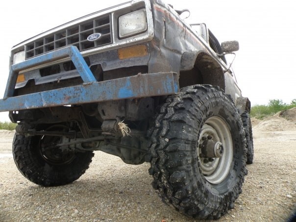

I'd love to see pics of that Bronco II. I used to have one of those in high school and college. I hated it but looking back, if I had money I bet I could've made it into a sweet trail rig.

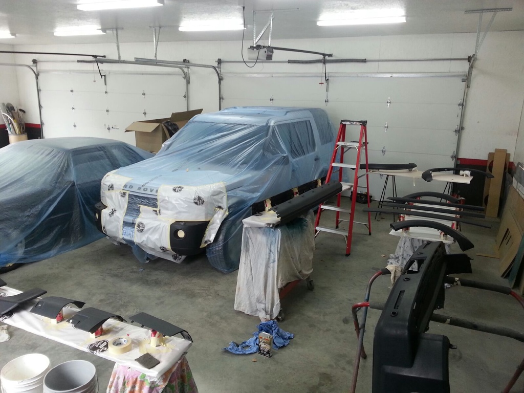

I painted all the lowers zamibizi silver i wasnt a fan of the black plastic reminded me of Rubbermaid so i striped it all and painted it i like it now. Just was like a face lift kinda.
Thats the only one i have handy

...be interesting to see how your LR3 compares to your B2 off-road. I regard my LR3 as the most competent 4x4 I've ever owned.
Of course, some wheel/tire choices would have to be re-visited before this showdown occurred. :)
