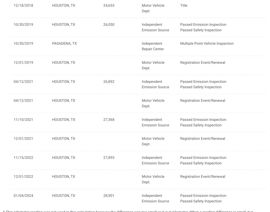

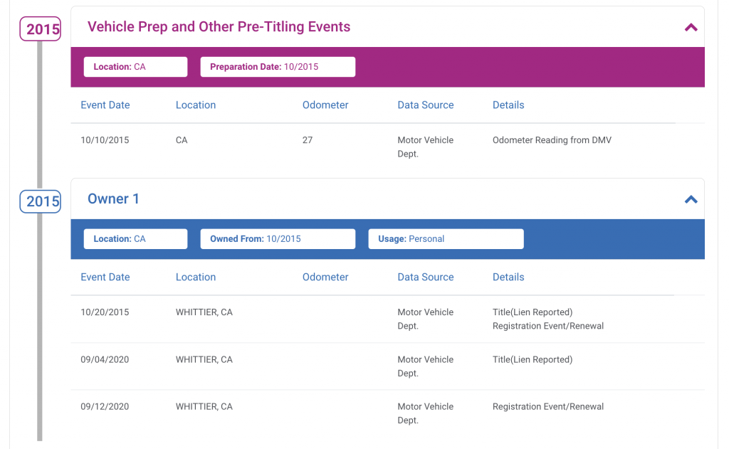

Thanks all. So the 43K one is at Carmax and when I looked at the Carfax the car had no entries at all (not even registration or smog) since 2020. Some of the dash looked melted, like it had sat in the sun too long. So that was crossed off. The other car is in Houston, and apparently since 2018 it had been driven a total of 848 miles TOTAL. Prior to that it was a corporate car and they put 25K on it in 2 years. It does't have the HD package, and I'd have to fly out there to look at it - and I'm just wondering if it's worth the $40K they're asking for it...
PS: this is the vehicle history for th 43K car... I've never seen anything like this and I've been looking at LR4s for over 6 mos...
PPS: I'm also attaching the history of the 29K car from the time it was sold by the corporate business.
