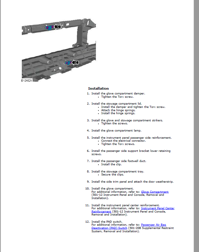

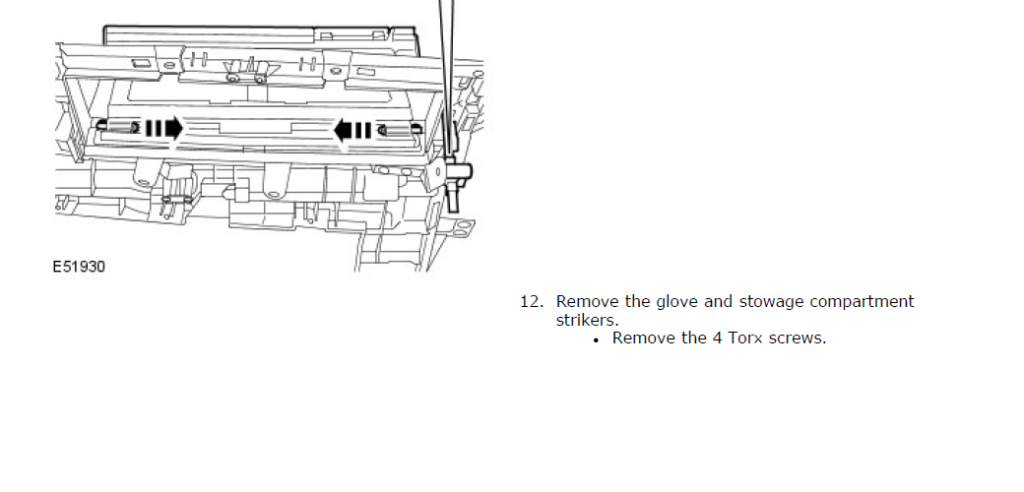

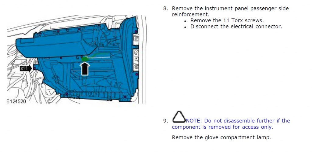

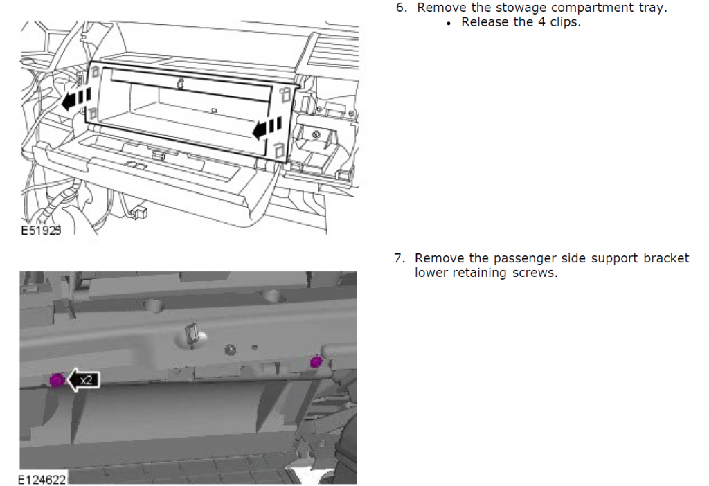

I thought this would be a quick 30 minute process and now i'm on my 2nd hour of trying to figure out how to remove and replace the upper glove box door. I see the pins on the hinge that need to be pushed in from the outer sides, but does that mean the center dash has to be removed?
It also seem like there is an arm attached to the dash door that pulls the door back and that needs to be screwed in to the retracting mechanism?
Has anyone done this before or have a repair manual? I am desperate for some help on how to get this door replaced.
TIA!

Thank you! It looks like this means the lower glovebox has to come off too? If so could you provide steps for that as well?
