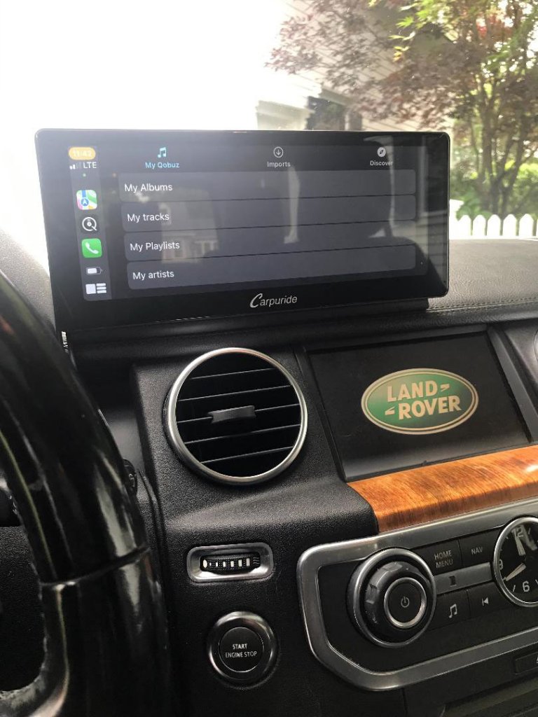

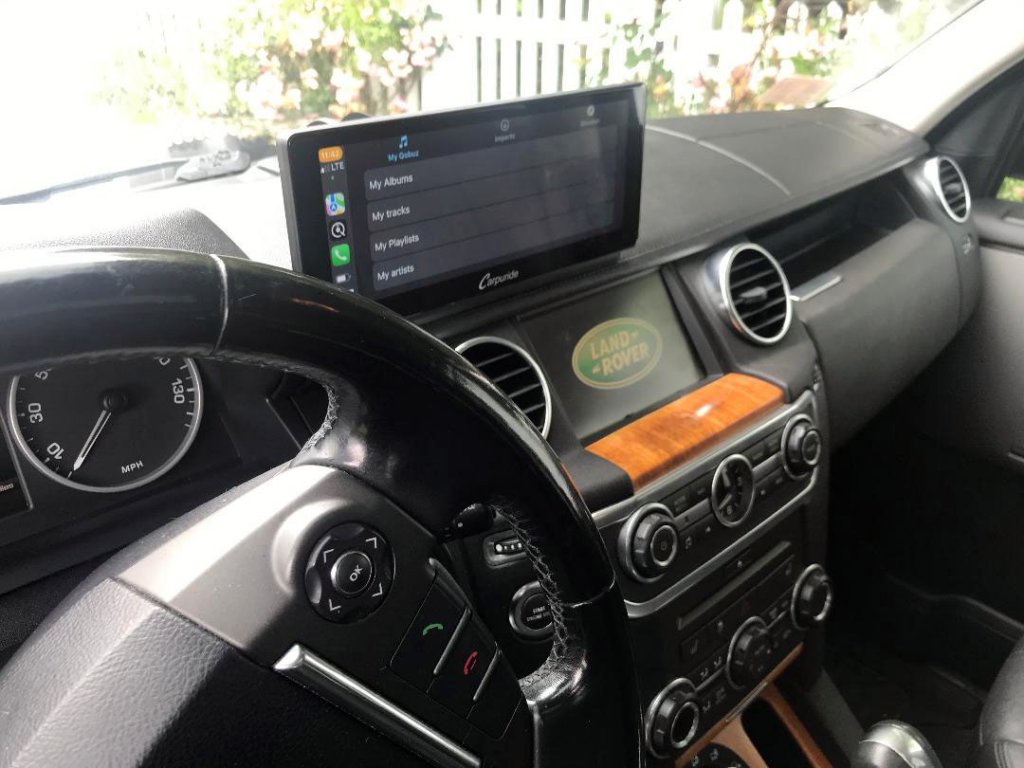

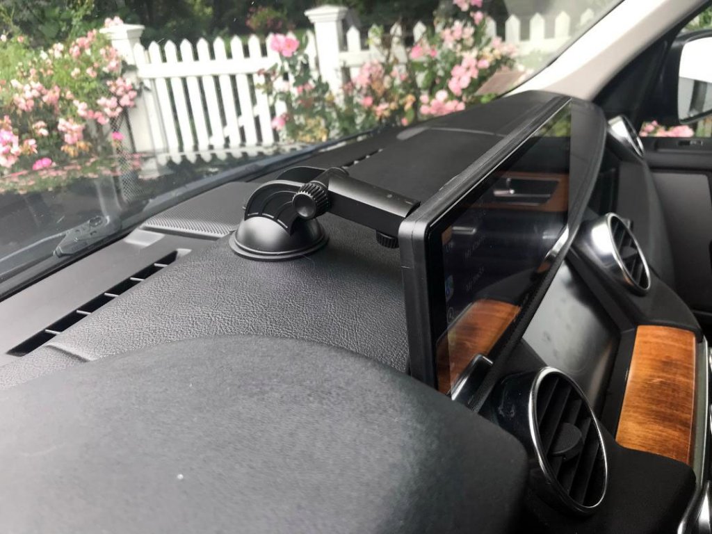

I mounted it to the dash with suction cup-so far it seems ok but I need to see how the heat affects it-if that doesn't work, I am going to try the adhesive pad. The front of the screen rests on the edge of the dash and I added small diameter adhesive rubber weather stripping to the bottom of the display for full contact to the dash, which keeps it from vibrating. I am using Qobuz for audio streaming from my phone and in all honesty, it sounds great-I will do more A/B testing to confirm and I am a "certifiable" audiophile. I have not had any other issues but need to use it more. As you mention, steering wheel controls only the volume now for audio, no track selection. I will take pictures when I have a chance.

Here's some pics. I flipped the arm of the suction cup around as well-seems to be a better angle for getting it lower on the dash. Next is to find a small Land Rover emblem on some black film to place over the logo on the display.

Looking good Franklin. Mine is positioned in the same spot, but just a bit back. Didn't want to attach the glue on suction to the leather. I have brown leather and I'm afraid it'll leave a visible mark.
Let me know what you find to hide that logo.

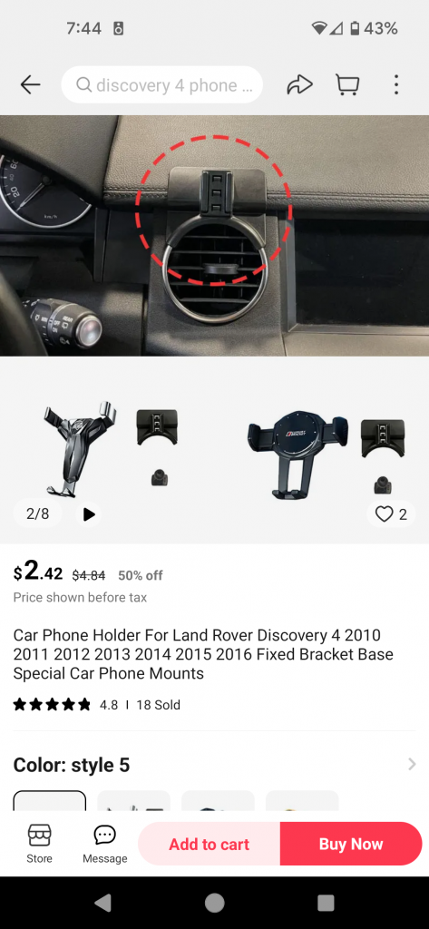

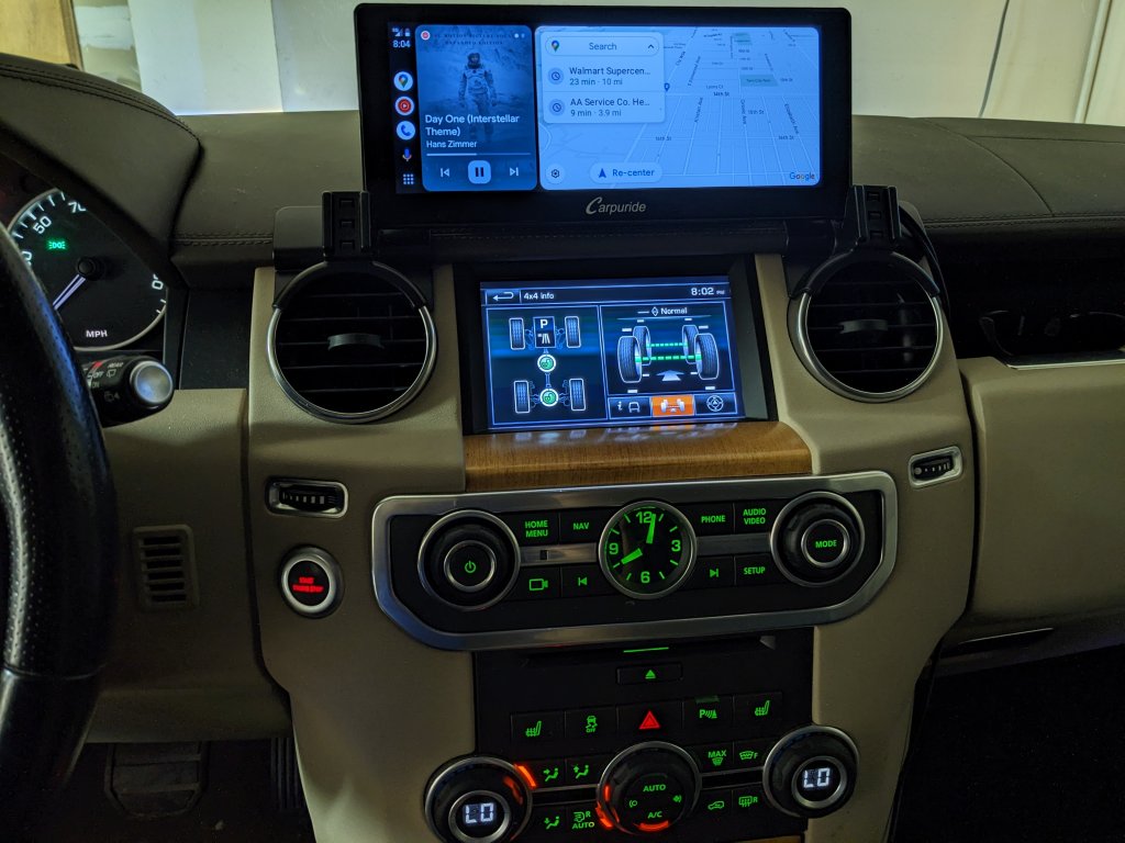

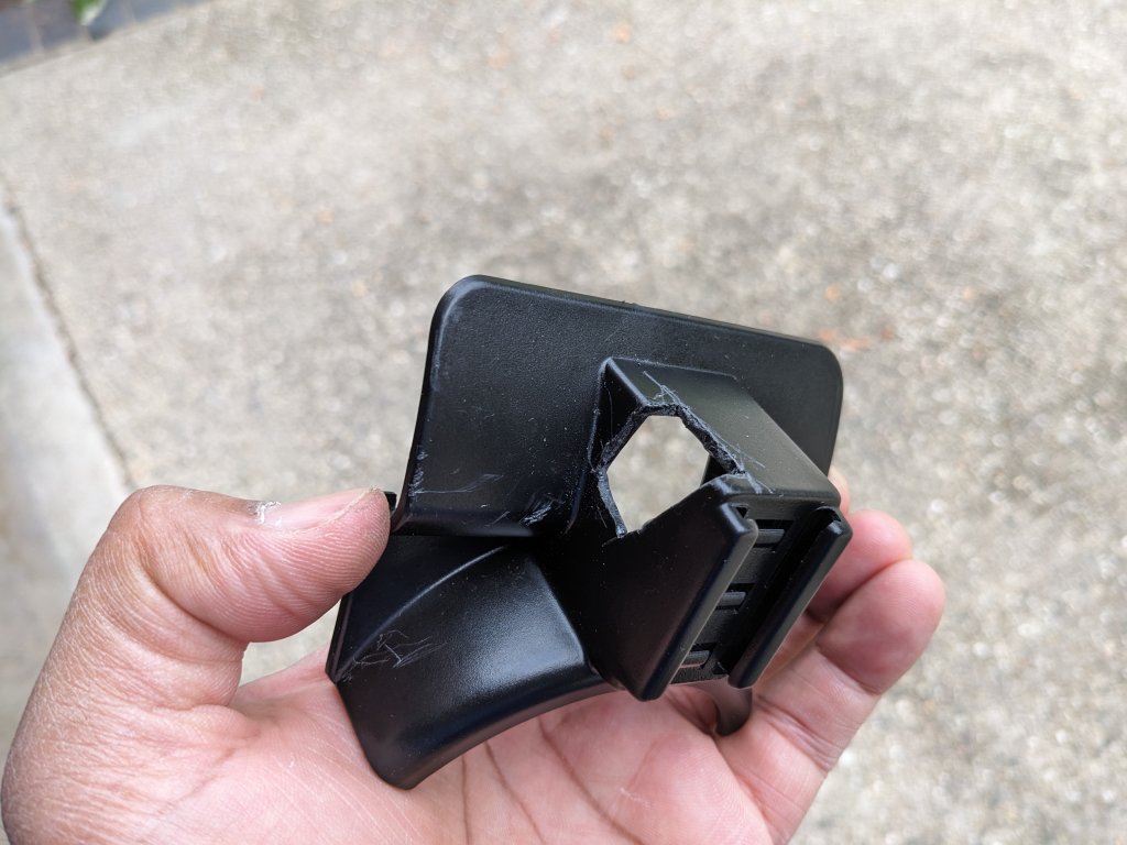

Here's what I'm leaning towards.
Found this phone mount on AliExpress for less that $2.5 each. Cut a small slit in the plastic to make a 'dock'. seems to be working fine. Stable enough, but ordered two more to cut narrower slots for increased stability.
