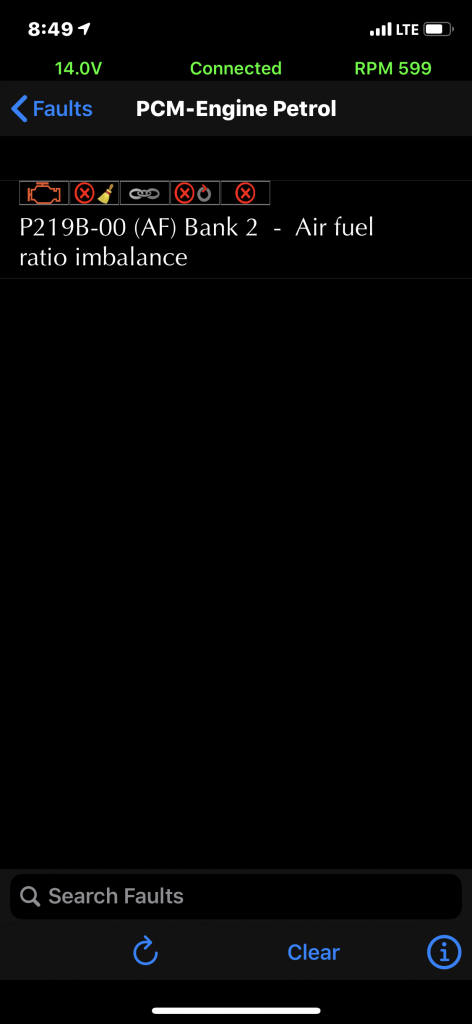

Hi,
I was driving my 2011 LR4 today and the check engine light came on. I pull the GAP scanner out to read the code and got this code: P219B Bank 2 Air/Fuel Ratio Imbalance. I tried to cleared it and see if it go away but it didn't. I figured there is something more serious that needs to be address. I did a little research on this and could be a O2 sensor, mass air flow sensor or something more serious.
Has anyone have had this error before and what was the fix?
Any suggestions or recommendations will be appreciated.

it means there's unmetered air coming in from somewhere....most likely somewhere in the exhaust. do a smoke test on the exhaust and see if there are any leaks you need to weld. It could also be an o2 sensor failing.
