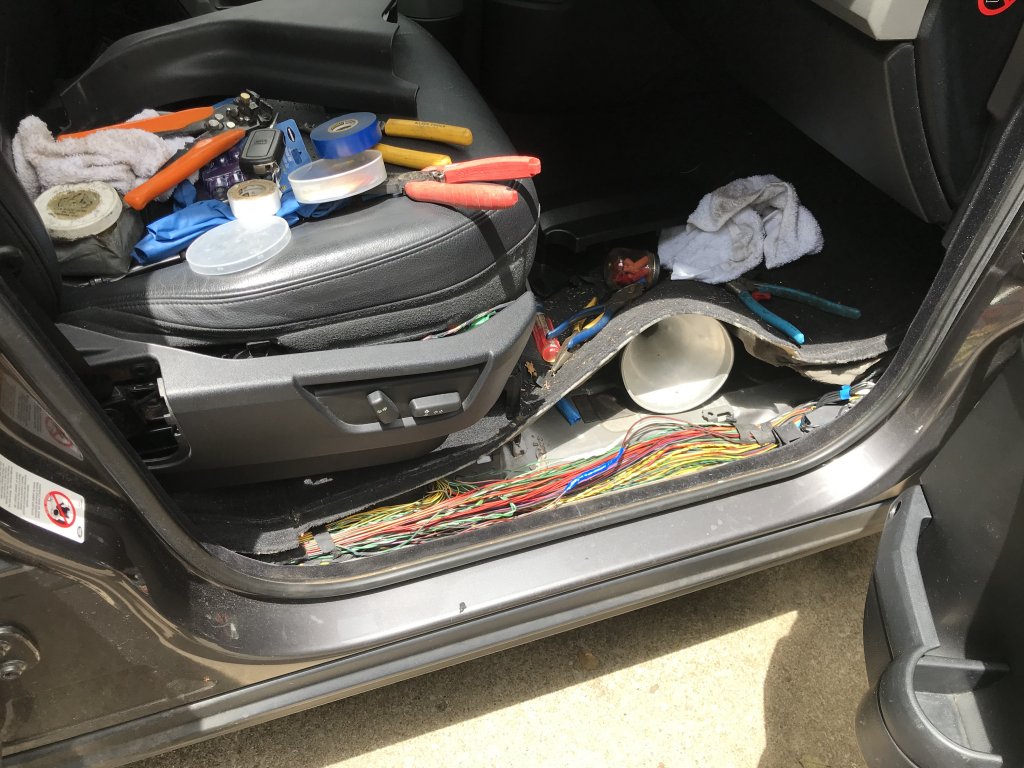

9500joseph
Dec 1, 2013
My had same problem there are 2 green and white wires connected to 1 green and white wire under passenger door Sill plate Connection goes bad, connection Is wrapped in Blue tape. I unwrapped tape cleaned wires and reconnected with good wire connector. Fixed problem. It’s buried in that mess of wires. It’s a little Tedious to get to but easy fix.
9500joseph
Dec 1, 2013
9500joseph
Dec 1, 2013
Also had To dry floors out, it took a few days with a fan. Thus the funnel in the picture holding carpet up.
