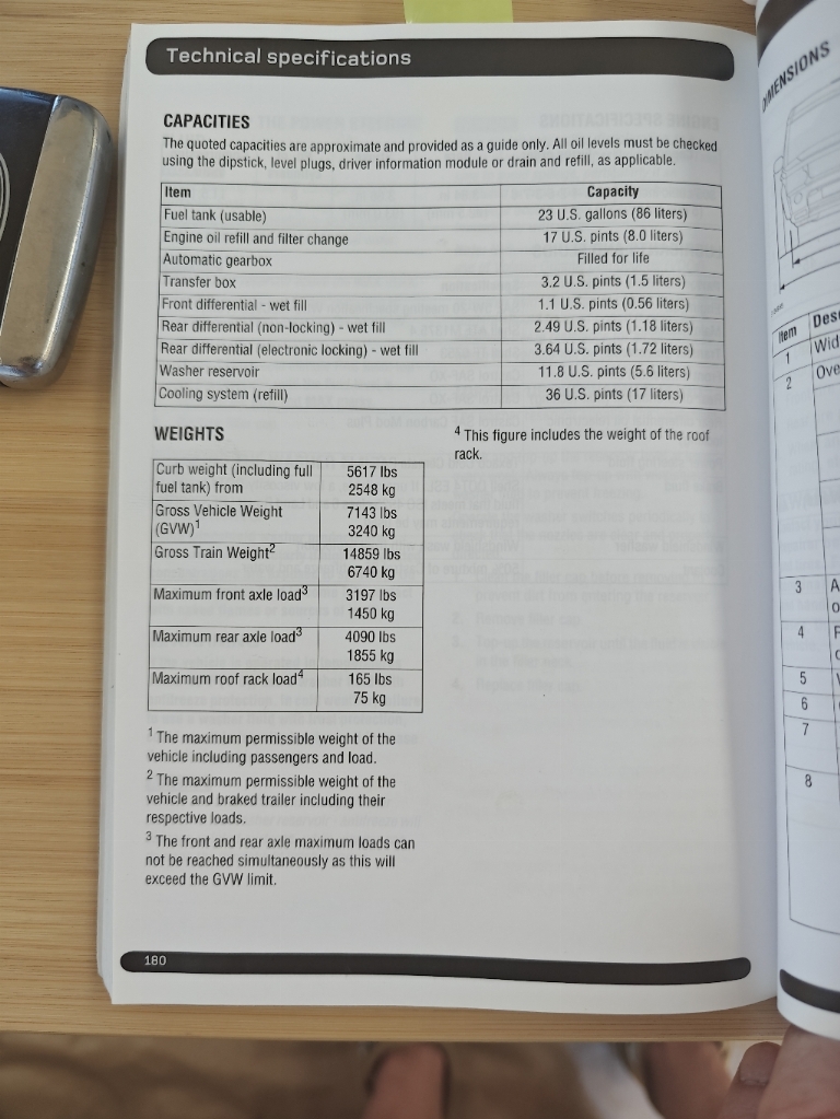

Has anyone weighed their rig unloaded?
powershift
Jul 20, 2023
742
226
Nevada
Reading through the manual I found the max rear axle load is just over 2 tons. It seems like the LR4 is a strong SUV truck. I see footnote 3, but I'm curious how much weight is on the rear axle unloaded in order to subtract that from the max rear axle load to get max payload back there. Does anyone have weight slips or the rear weight by itself?
